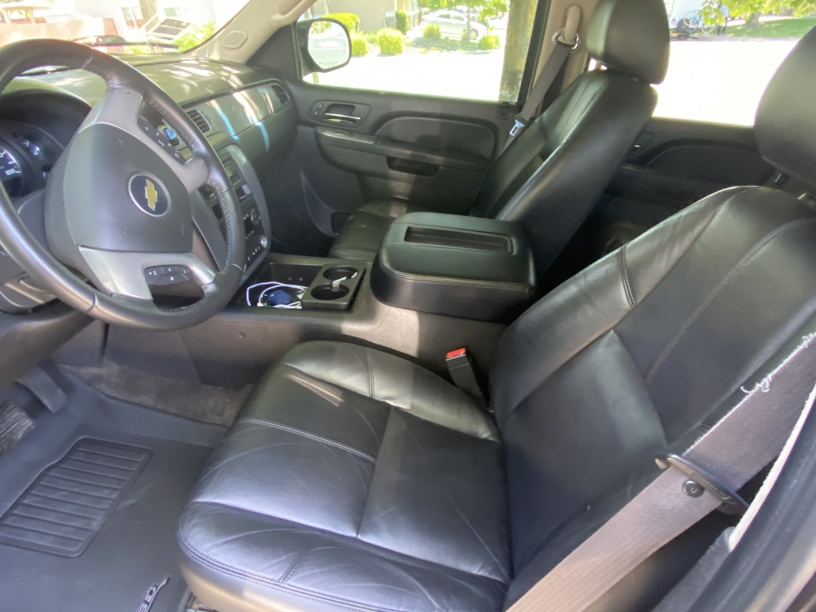

well my 2011 Chevy Tahoe lower drives side seat is cracked and needs replacing. I want to replace the foam seating as well. I want to try to replace it myself but this isn’t something I can get wrong and expect to drive the Tahoe comfortably .
Does anyone know what the dealer charges? Do you recommend buying the parts and taking it to someone that can assemble it.? I’ve been doing research and the foam and seat cover runs together about $300 dollars. I don’t have the tools to dissemble and resemble.
Thanks ahead of time.
Ken

Aftermarket is the way to go. Especially in black, as the color match is exact. OEM padding is still available and around $1h for the base. It can be done without removing the seat and takes a few hours your first time.
Check out the YouTube videos. It makes a hellava difference. The dealer would get you for about 5-$6h for one base. Aftermarket is about $2h per base.
