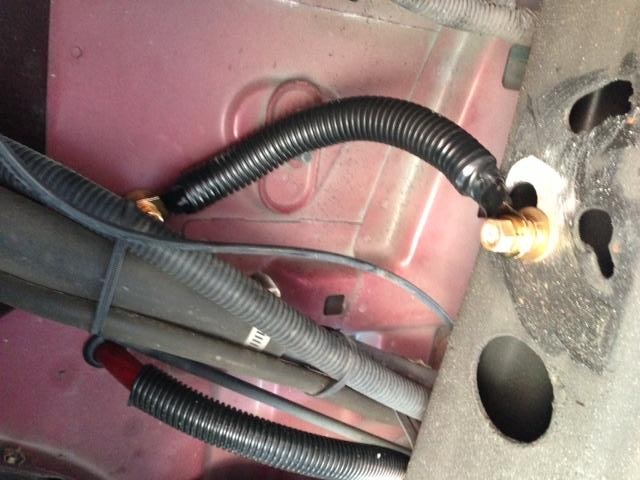

This is what I did...
I went from the battery down the frame and came up on the driverside rear...
You can see my ground and the power going through
K

Thanks for the replies guys. Would I need to drill any holes or are there pre-existing ones that I can use?
NathanJax
Vacation Nathan
Administrator
May 9, 2009
49,136
943,577,177
Jax, Fl
Need to drill
