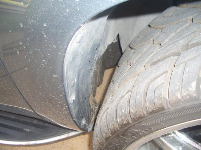

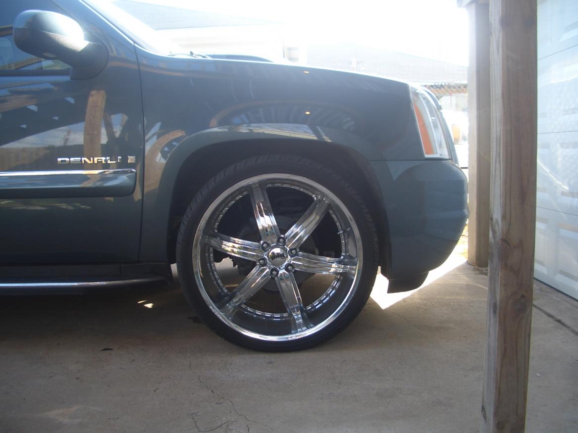

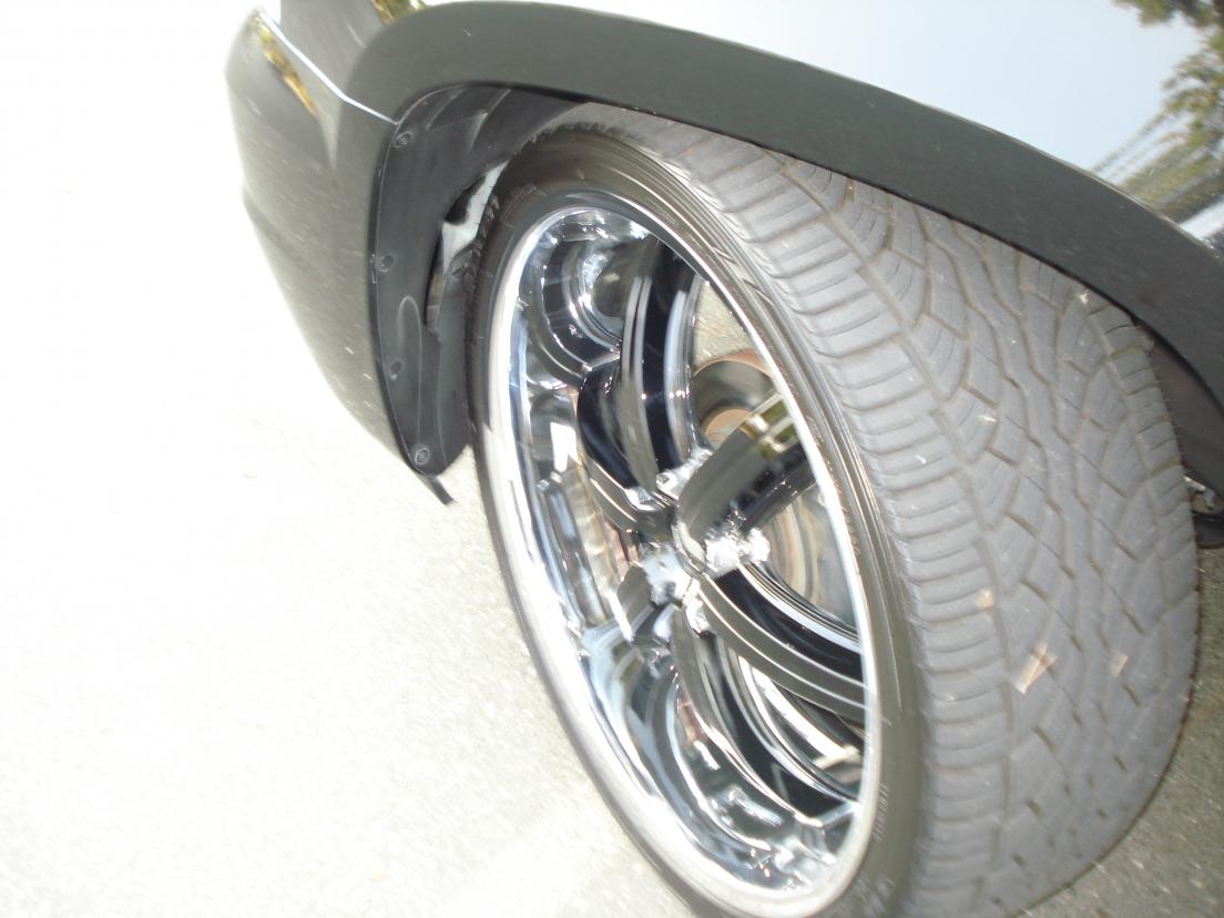

here are some pics sorry its dirty got back from texas heatwave and havent had time to clean it

Thats a lot of cutting to still see rubbing issues!!

i had to cut the hell out of mine. and it still rubs on the washer reservoir.. a buddy of mine is dropped 3/5 on 6s. he actually did a mini tub on the firewall. and moved the entire reservoir to a diff location. if its still doin it bad then thats the only option you have is to relocate it

thanks for all the help i guess i will have to relocate the reservoir and sensors with it
