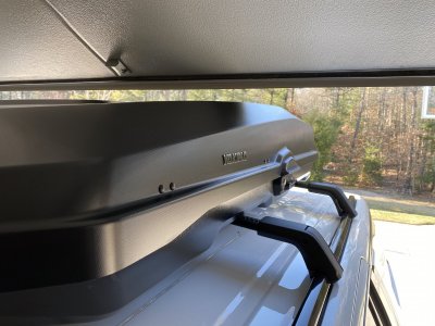

I am pretty happy to report that everything worked out as planned. This big beast fits through my garage door with cargo box on top. I’ll have to say it looks pretty good too.
To answer my original question, the OEM roof rack cross bars peak at 4.5” above the center of my roof which, on the Tahoe, has a slight valley along the center of the roof where the measurement is taken. The height it adds changes depending on where the cross bars are. At my front location it only measures 4” higher than the bottom of that valley.
For anyone interested, this box is the Yakima CBX16. It clears my 8’ tall (95” clear) garage door by 1.5” on my unloaded RST. For a point of reference, the top of the rear wheel well opening is 37” high on this vehicle with it unloaded. Surprisingly, mileage did not take much of a hit, even at freeway speeds. Maybe 1 mpg at 75 and 2 mpg at 80. I was certainly expecting worse.
