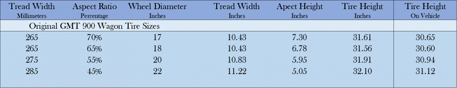

Lets say, for example, 265/70R17 (31.60" tall) or 265/65R18 (31.56" tall) or 265/55R20 (31.47" tall).
The worse the roads, 17" tire will protect the wheel / suspension / steering from impacts better than the 18", & the 18" tire will protect better than the 20",
because the 17" tire has 7.3" of sidewall, vs the 18" tire's 6.7" of sidewall, vs the 20" tire's 5.7" of sidewall.

I also have a 2003 Denali, and have been running 305/40R22s on it for almost 4 years. It rides smooth as one could expect a 21 year old truck to. I am switching to 275/65R18s for aesthetics and more off-road capability, but if they ride smoother as a bi-product then cool beans, but it rides pretty smooth currently. New tires will be .5" taller and 1.2" narrower.

Had the 18s for a couple of weeks now and there isn't much of a difference honestly. I can definitely tell when crossing certain bridges (the gaps between the concrete segments), and railroad crossings. I'm not sure if that is a testament to the Z55 or if there was a trade-off losing 120mm of road contact with the narrower tires, but it's not as dramatic as I imagined. Still happy with them.
