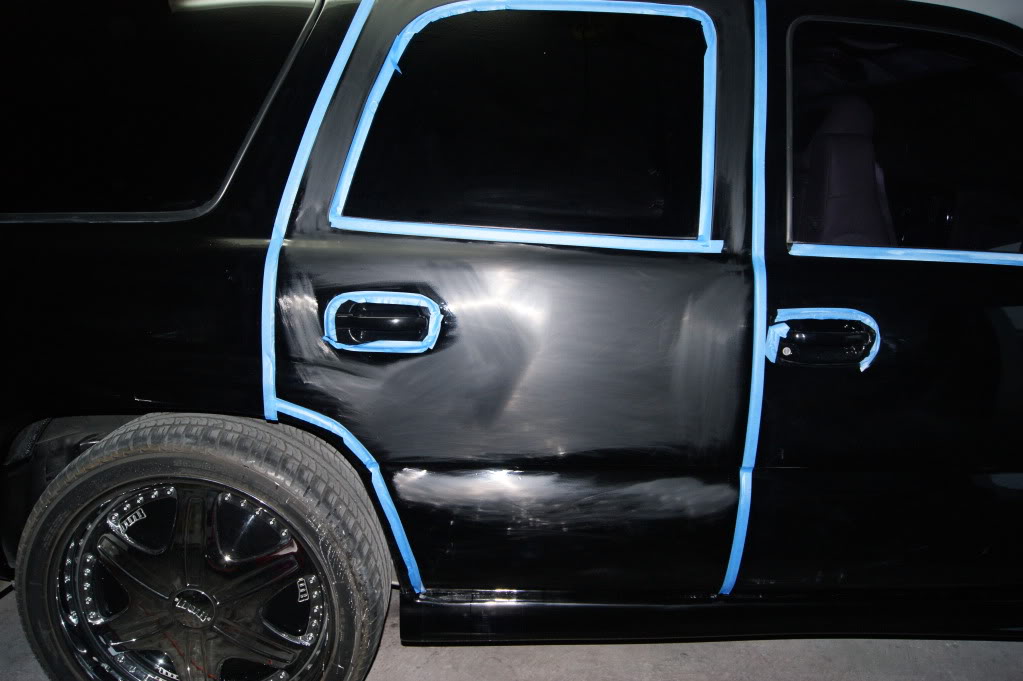

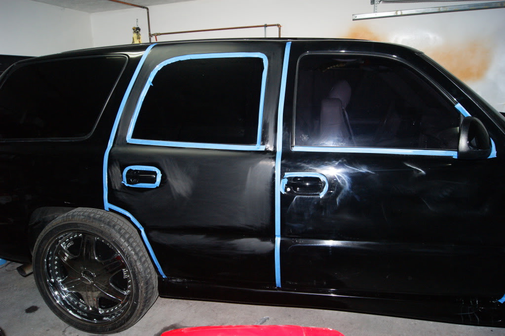

started wet sanding, and its looking real good

did you tape the edges so you would not sand through? looks awesome btw
yes youi tape the edges to avoid sand through and keep all the compound from getting in all the nooks and crannies saves time on cleaning up
