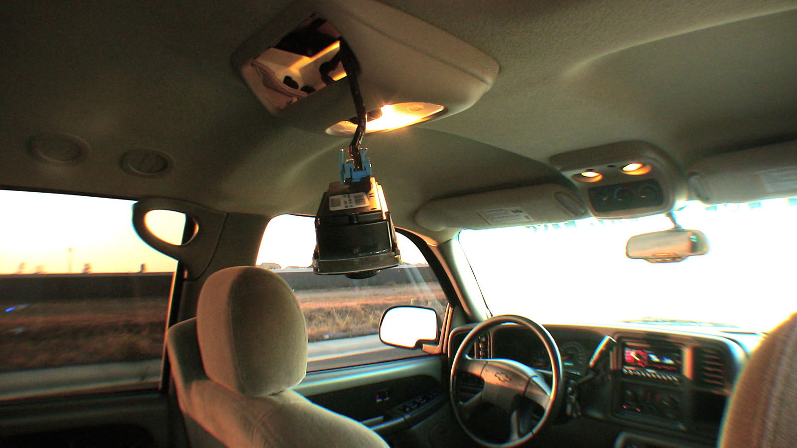

can't seem to get my camera to work so I'll find some older pictures.. hopefully this helps

Oh awesome, you didn't even need to pull the whole box down. Do you know if the front overhead hvac comes out the same way?

both the front and the rear my sub snapped out you can see in the second picture the bottom right tab is broken off not even there.. they are tiny so I can see why.
the front is way easier to deal with because you just take one screw off towards the windshield and there are clips by the map lights.
the rear is different.. there are clips closest to the windshield and then torx underneath the HVAC so you have to take it out but like I said just pry it out
or get an 18 on 1k watts and slam the shit out of it :D
the first time I took it out I used the flat head, then siliconed the housing so it wouldn't rattle
