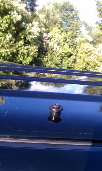

ok i went to remove the esky and got the caps off but couldnt get the bars off. there is a hidden screw and i dont know how to get to it. i tried sliding the rack front to back but couldnt get it.. any ideas???

There is a bolt in the front back and middle-ish area

how to get the one in the middle out is my question? there is no access to it

SUMO has a great thread on installing them.. but i still cant get an answer to how to get the chrome bars off this nut. heres a pic from his thread of the nut..

Slide the rack either forwards or backwards. There is a notch in the rack that will let it come off of that nut.

thanks man.. i was sliding, wiggling, pulling the shit out that thing and it wouldnt come off. i ran out of time but im goin back tomorrow so hopefully ill get it.. oh and if anyone would be interested in the cross rails ill sell them!

anyone have any tricks to do this?

You just have to find the right spot in the rail. You slide it either forwards or backwards to the right spot and lift straight up. See if you can get on a ladder and look through the rail to see where the hole is.
