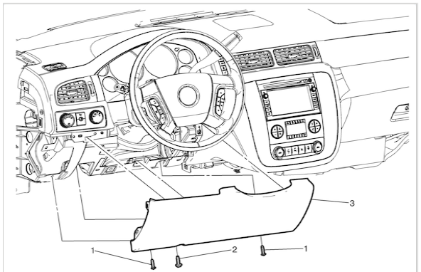

I have to get at my BCM, have removed from my 2009 Yukon the 2 screws but the lower dash is still solidly hooked up. I am not flexible enough to get my fat head under to look. Are there more clips or something? I also spotted a bolt under the brake release is that it?
Yes, you have to remove that 10mm bolt near the parking brake release, then you can remove the knee bolster panel.
Thanks, @swathdiver . As always, your knowledge and willingness to share (as well as many other members of this Forum) help make this Forum as successful as it is.
