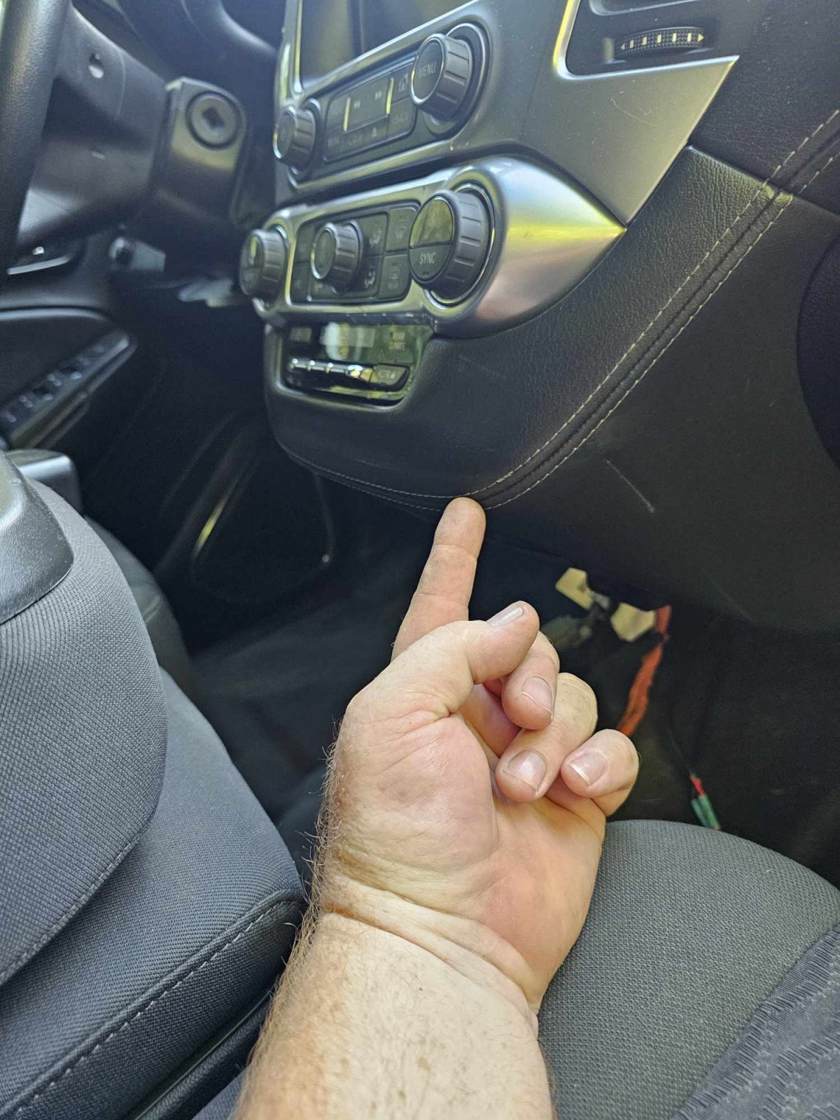

I think only PPV Tahoes have this lower dash trim? Anyone know how to remove it? Its 2015 - 2020 models

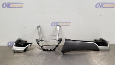

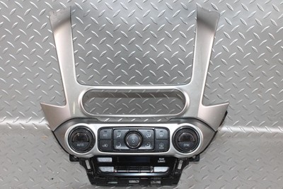

I believe you have to remove the left & right side panels first then it will look like these

That lower rubber pocket… pop that out and there are screws behind it, then the trim piece pops off.
