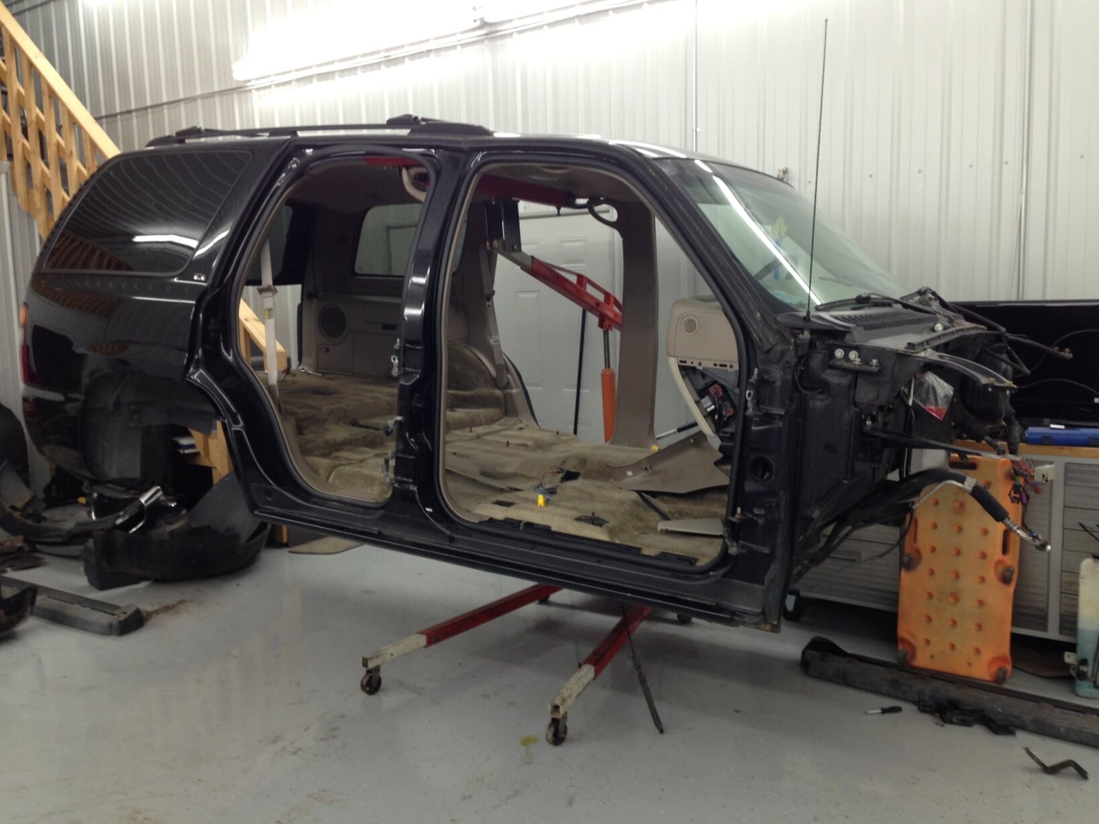

I have had a 2002 Yukon SLE 2WD for 10-12 years. A few years ago, I had some major damage to the body. I found a local 2001 4WD truck that had better luxury options, but the ddrivetrain was crap.
Long story short, I installed the 4WD body onto my 2WD drivetrain and got everything working.
Now I have error messages because I think it is looking for the 4WD system sensors.
Does anyone have any advice on how to proceed? This truck is beautiful now (new paint, interior, etc.) but it has been sitting in storage for past 3-4 years because of these codes...)
