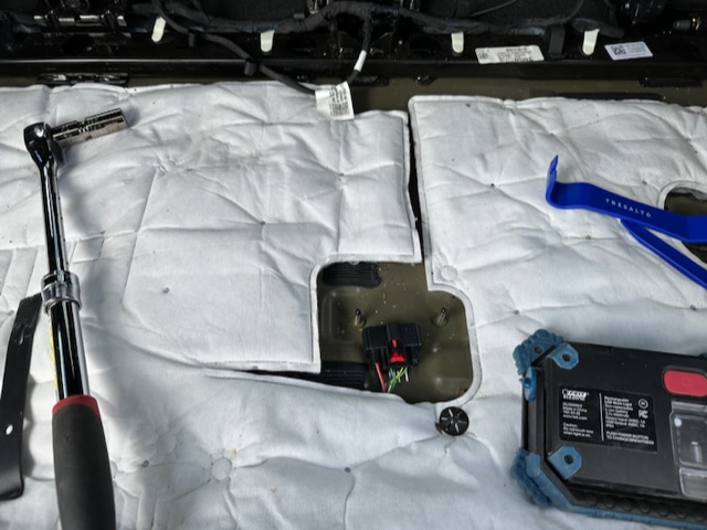

Thanks Stephen, that helped a lot. A few notes from what I saw:
* cargo tray only had two plastic nuts holding it on that you can remove by hand.
* there were five bolts in the rear of the seat and three in the front.
* wiring harness was under the cargo tray and came apart fairly easily once I a) slid the red clip back and b) stuck a screw driver in the slot on top towards the front.

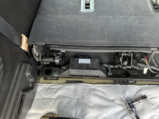

Can you snap a pic of what it looks like removed?

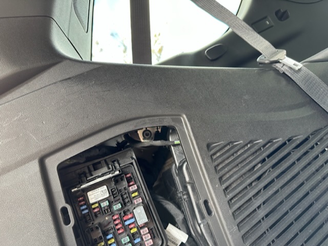

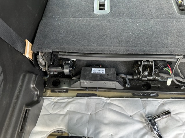

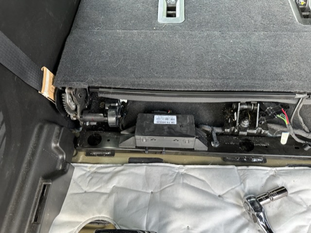

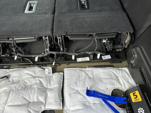

Here are the pictures I took. The white pad is what’s beneath the cargo tray and the seats are folded down. I never fully removed the seats, just took all the bolts out and slid it forward a few inches so I could access the lower seat belt anchor.
