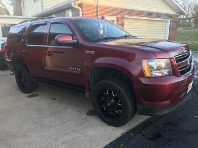

Old thread but just to add some info in case other people are looking at buying GM Hybrid. I bought a 2009 Chevy Tahoe Hybrid 4 months ago and have driven it approx. 5,000 miles so far. I paid $6,600.00 cash for it and it had 196,000 miles on it. I just ordered a New Hybrid battery last Friday. I bought the truck cheap enough to allow for that cost. I could limp along for years with the old deteriorated battery but I want to experience the Hybrid Tahoe like it was when new. After I bought it I changed all the fluids installed 2 new front wheel bearings a new rear window to fix the defrost grid and some other small stuff like a headlight and taillight bulb. The thing drives great and with the 3.5 inch lift / 20x10 Mayhem wheels and Nitto Grapplers it is a cool ride. If I could find another just like it that i could buy at 6600 I would buy it today no joke. It will be interesting to see if the mpg changes with the new battery installed. Currently at 17.1 mpg over the last almost 5,000 miles that I have driven it. I am kind of an aggressive driver and the nearly 400hp that is available (6.0 = 332 and 85KW electric motor = 65hp) does tempt me a lot LOL This 6200 lb Behemoth with that much HP on tap at your right foots demand is no slouch. plus with the lift/wheels and tires it would be real easy to crush up some Priuss (aka penalty box cars) "just sayin"

Update new hybrid battery installed. I really cannot tell a lot of difference in the way it drives and only a tiny mpg increase so far, currently at 17.5mpg average over 1000 miles with the new battery versus 17.1 over approx 6000 miles on old battery. It will never produce "great" mpg with the lift/oversize wheel-tires and the current driver LOL. I am still under 10k invested for a unique 4x4 that runs great and actually looks pretty cool. The 09 hybrid had some pretty good std features - Leather Heated front seats/sunroof/DVD system/dual climate/folding mirrors/LED tailights etc. I am pretty pleased with the ole ** so far. I just bought it as a daily driver "Beater" and it is perfect in its roll LOL
