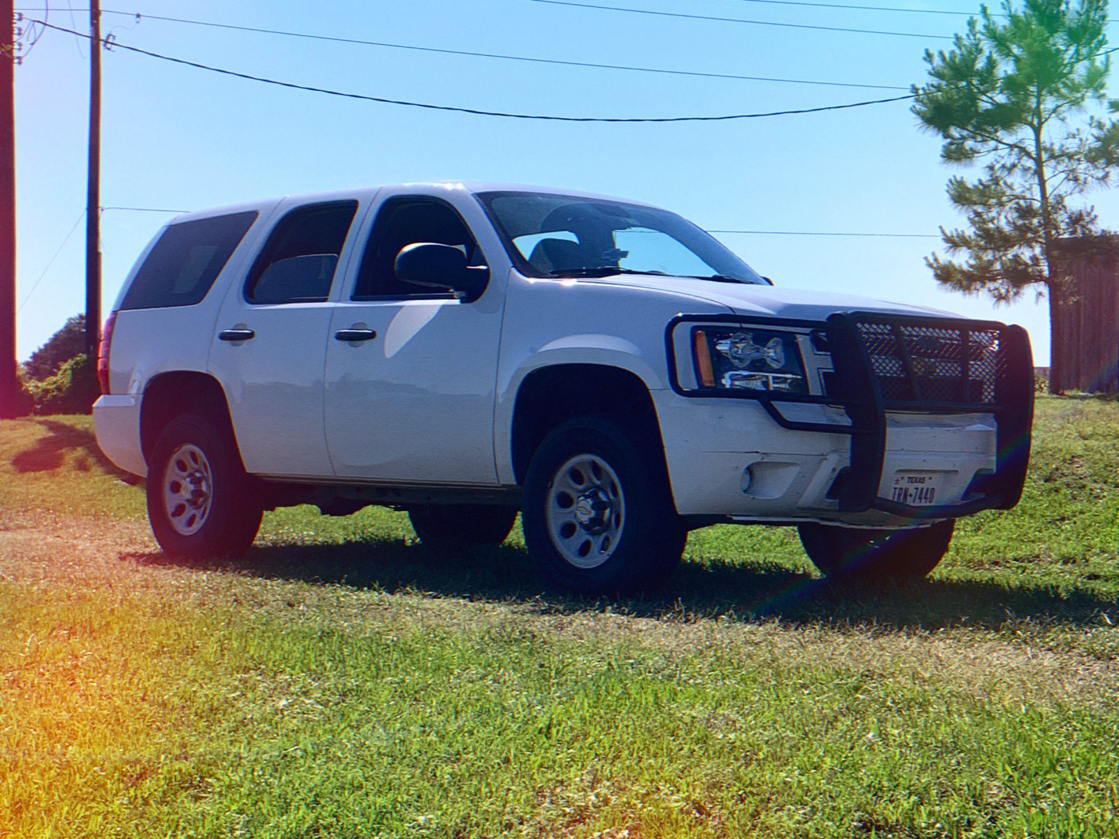

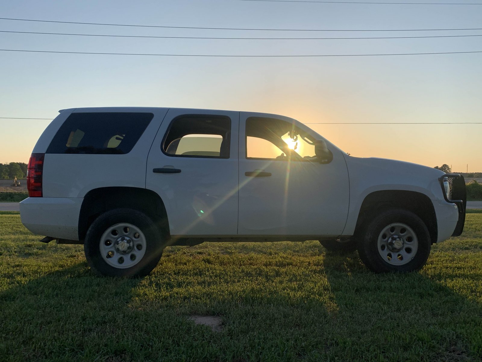

So im looking into getting a good suspension setup for my truck, I know very little about suspensions (im an engine nerd) so if anyone got any good setup suggestions lmk, Im cool with lifting but nothing crazy (middle price range)

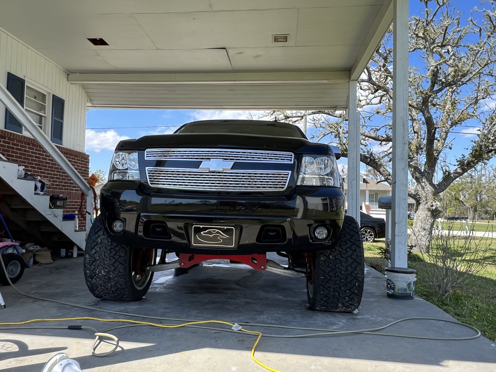

On my rig I got kryptonite wheel hubs and lower ball joints with a fabtech 6” stretched to 8” with a 2” leveling kit under the coil over
The strut I swapped to an icon coil over but fox or king shocks may ride better also there’s other options slightly cheaper then that if your on a budget.
Fabtech uniball upper control arms
And kryptonite sway bar links
the ride and handling would be transformed completely

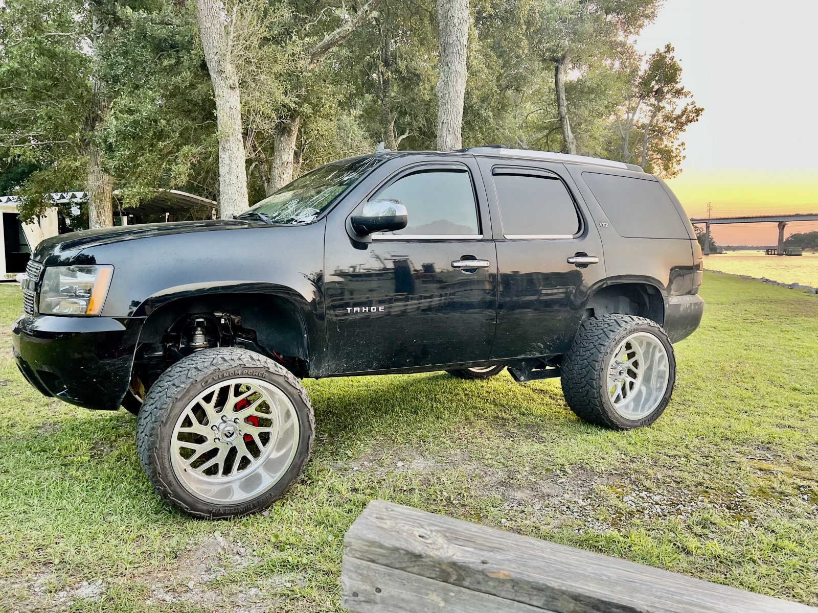

I’d go with a fabtech or mcgaughys lift they give the best angles for that height
Rough country’s 7.5” is nothing but a stretched out 5” lift so all the angles aren’t good at all… you can still make the cheap rough country or maxtrac lift ride good with nice coil overs and upper control arms but out the box it’s not very good at all and I’ve never had good luck with the RC uca or their shocks that’s just me personally
Fabtech makes a 6” and mcgaughys makes a 7-9” I’ve got both and are happy with both lifts now I’m on the search for some good coil overs (fox/kings/etc) my icons are wore out and in need of a service
Note if you go the coil over route keep your stock struts or whatever struts come with the lift kit you choose so when you need to rebuild or service the shocks down the road you’ll have a second set of struts to put on so you don’t go down a vehicle
This is at 8.5” and my angles are still perfect
