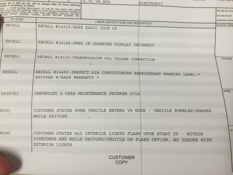

took the Tahoe to the Dealership today. My letter only addressed 2 recalls, but the service writer ended up saying I had 4 recalls total.
They've had it all day trying to get just 1 recall done. The PCM reprogram isn't working. Tech had tried flashing the PCM 5 times with no success. Apparently you have to wait 1 hr between flash attempts.
Hopefully the damn AFM (V-4 mode) crap can get fixed while they have it. I am so tired of the rumbling. Feels like a tire is out of balance whenever that shit is active.

GM developed another way of programming the PCM. They revived my PCM from DOA status and did the last 2 updates.
Didn't fix the interior lights flashing.
The freon sticker from factory had incorrect Freon amount. So they have been over-filling some Tahoes with too much Freon. Mine had the entire charge evacuated and properly refilled.
