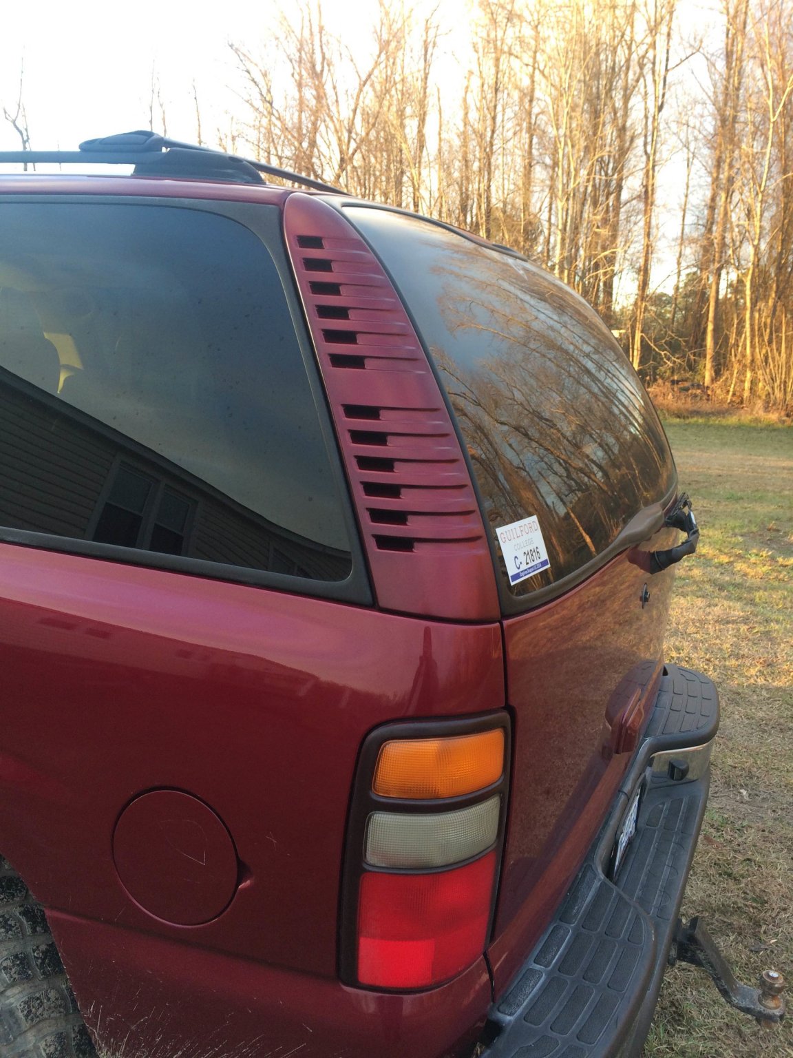

I know it has been discussed before but I am trying to paint the rear vent caps and only see one screw. In other post that I have read in the past there are two screws. I have been looking for the post describing where the other screw is but I cant seem to find those posts. Can someone help me locate both of the screws. Thanks!

There is only 1 screw at the top as shown here. There are 3 plastic tabs that hold the vent in place on the outside part of the vent. Pull hard, it will sound like you are going to break it, but keep pulling as the plastic tabs are bent like a W which holds them in place to D pillar just behind the rear window.
Just be careful when you pull the vent out as the top sometimes tries to catch the window at the top and will want to try to separate the part where the screw goes and the part where they seam together. Good luck.

Thanks man! I will post pictures when I am done.

It was pretty easy and makes a difference. I think I'm gonna do the front plastic bumper that holds the fog lights. What do y'all think?

@Juiceman74 How did you paint the vents? Or did you take it to a body shop? Thanks man looks good my Tahoe is the same color

You can do it either way depending on your confidence (not hard with some color matched rattle can paint and clear coat after some primer and sanding).
Here is where I have gotten all my paint.
www.automotivetouchup.com
Or how well you get on with the body shop. Good luck.
