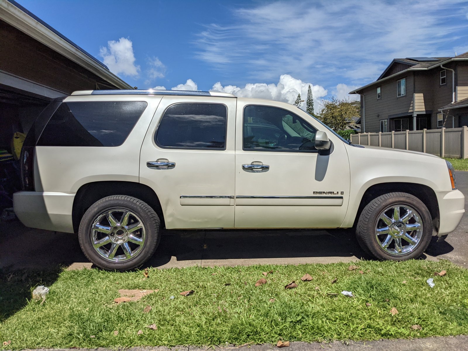

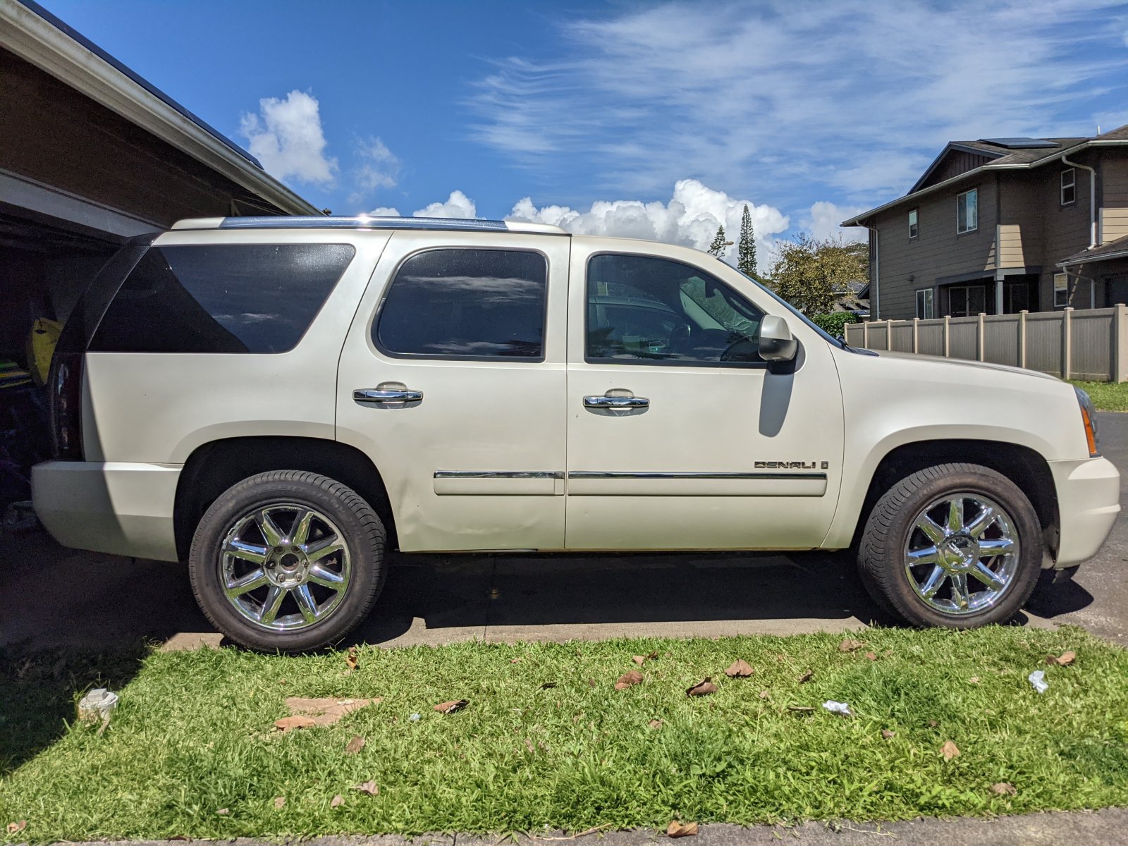

Before:
After:
Is it sitting too high? Maybe these were the wrong springs.

springs are probably good. unless you used the 80169, those will be about 3/4" taller than factory. things will settle as the springs break in and any new rubber parts squish a bit. When you do the fronts with OEM spec things it will even out.
