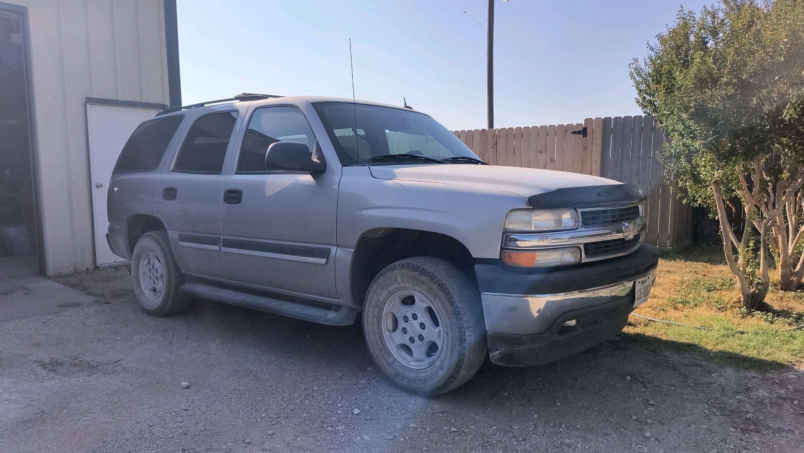

Thanks for the replies. This is the only photo I have of it at the moment, after driving down a dusty road to get to the house. I'll try to get a few more this evening.
