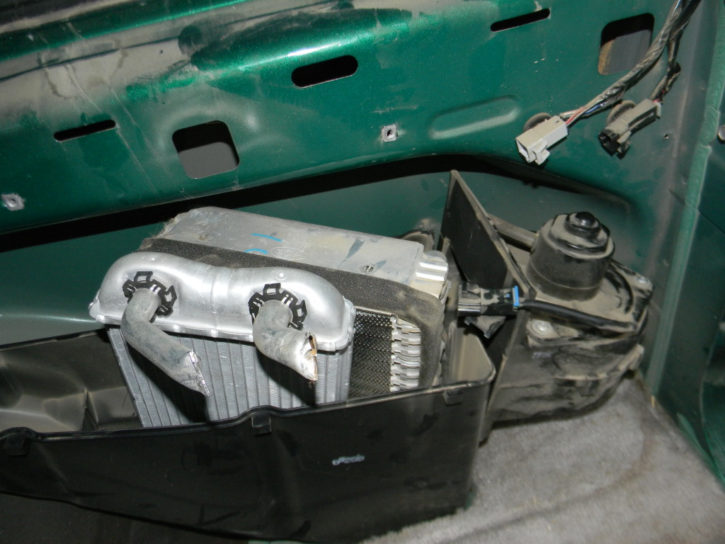

Here is a pic of what I've found:
The heater core from the Suburban is a little big:
Something smaller sized could work. My idea right now is to put a heater core there, plumb it in, but put a cut-off valve under the hood for the rear heat. I figure since the rear a/c is on or off, the rear heat can be on or off, and just control the amount of heat with the fan. I would get one that has the hose couplings on the side to make drilling easier for the hoses though the body.

I wonder if a heater core from a small car is smaller than that? Or maybe a small radiator from a dirt bike/motorcycle might work?
