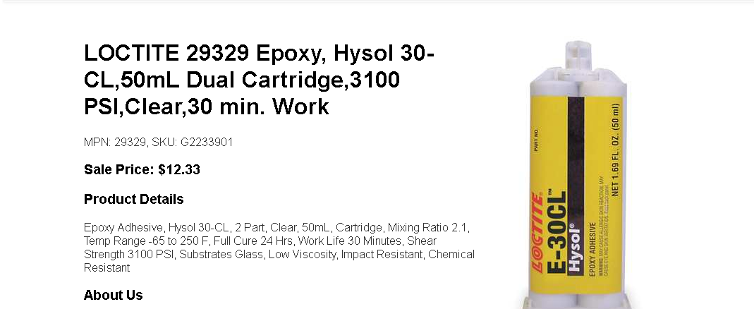

one of my tabs came off the other day i bought the glass in april so there going to solder it at the dealer, once that is done im going to put some of this on it afterwards as a backup, hopefully this will help it hold

I have used the permatex twice. The first installation worked for about 9 months and then it popped off again. The second didnt work at all. I think because of the cold weather during installation.
is that epoxy just to hold the tab on after solder? So it wouldnt work without solder?

no I bought it to put on afterwards as a additional coating (to keep it in place),not electrically conductive, but it's pretty heavy duty stuff, dry's clear and bonds to glass and is good for up to about 250deg, it was around $34 on amazon
