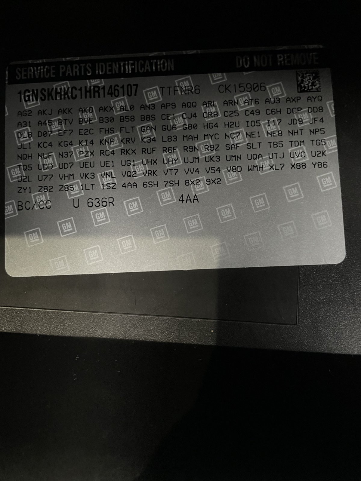

I am looking to replace my rear shocks, and am having trouble determining which suspension I have and in turn what Arnott shocks to order.
First a little background:
2017 Chevrolet Suburban 4WD LT with I believe Max Trailering, as it has a trailer brake controller.
Over loaded Suburban with over loaded trailer got the best of me, heard /felt a letdown on one shock or the other and now the compressor is running quite a bit and the shocks seem to be riding higher than usual.
Can you tell from the RPO codes and pass on any advice? I like the smooth ride feature, but about once or twice a year I haul a ton of stuff. I already upgraded my brakes to milled and slotted rotors and am not against updating the suspension.
Thank you in advance for any help!

Not as familiar with the 2015-2020 years but from what I can tell, you have Z85 which I’m pretty sure is Standard Air suspension and 6SH/7SH for front suspension codes and will want to pay attention to when buying new front struts.
Here is a list of RPO codes for your year of vehicle.
I would definitely get underneath and check the bladders on your shocks and associated air lines for leaks with a spray bottle of soapy water.
I think Arnott AS-3066 is the rear shock for you as you do not appear to have Magnaride, which I believe is RPO Z95.

So if we have Z85 (2016 Suburban LT), what do you do with the electronic connector wire on the AS-3066?
