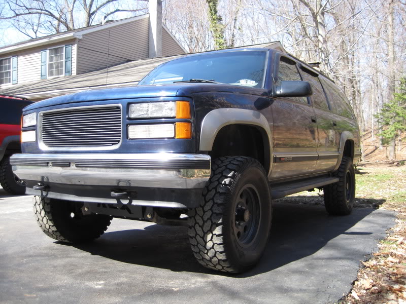

I do like the RCX. No issues with it and a good price. I do not know much about the Superlift DonnieYukon runs it I believe.
But the RCX kit is a simple install. Most bad reviews you come across was the old kit, they redesigned and did it well. The RCX drops the differential 5.125". I run 35x12.5 on my suburban and needed minimal trimming on the running board to clear at full lock with no rub. I will get some pictures up tomorrow when I am home. All in all I do like it. Not as much as my other truck's kit. But considering what I use as a comparison this is a good kit.
Plus it came with the longer brake lines...it was a true complete kit. I opted for SS braided lines anyway but my point stands.

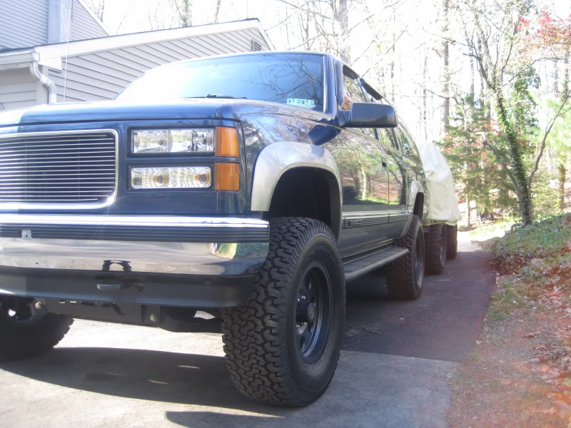

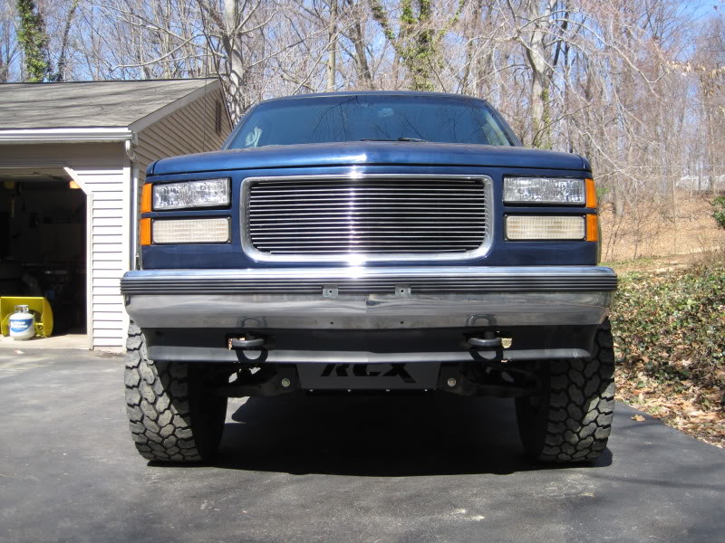

A few older pictures but nothing has changed
