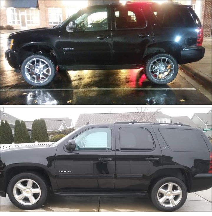

I have the same set-up. 3.5" lift, 22 inch snowflake replicas and 33x12.50x22 tires. Kinda wish I would have went with black wheels. No spacers and no rubbing.
