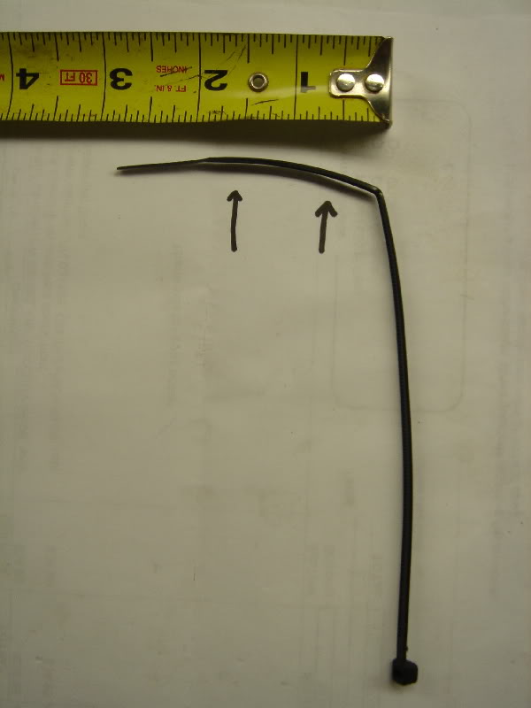

As Hapyspaz has stated, the GM shop manual does recommend .6-1.6 below the hole on non-HD models.
The easiest way to measure is to just take a clean wire zip tie and use it as a dipstick. It may take a couple of tries of getting it in without hitting any obtructions. I find that right when i insert it in, if I angle it towards me and hug the inner wall, it will take an accurate measurement.
For example, in my pic, the level should be between the arrows.
