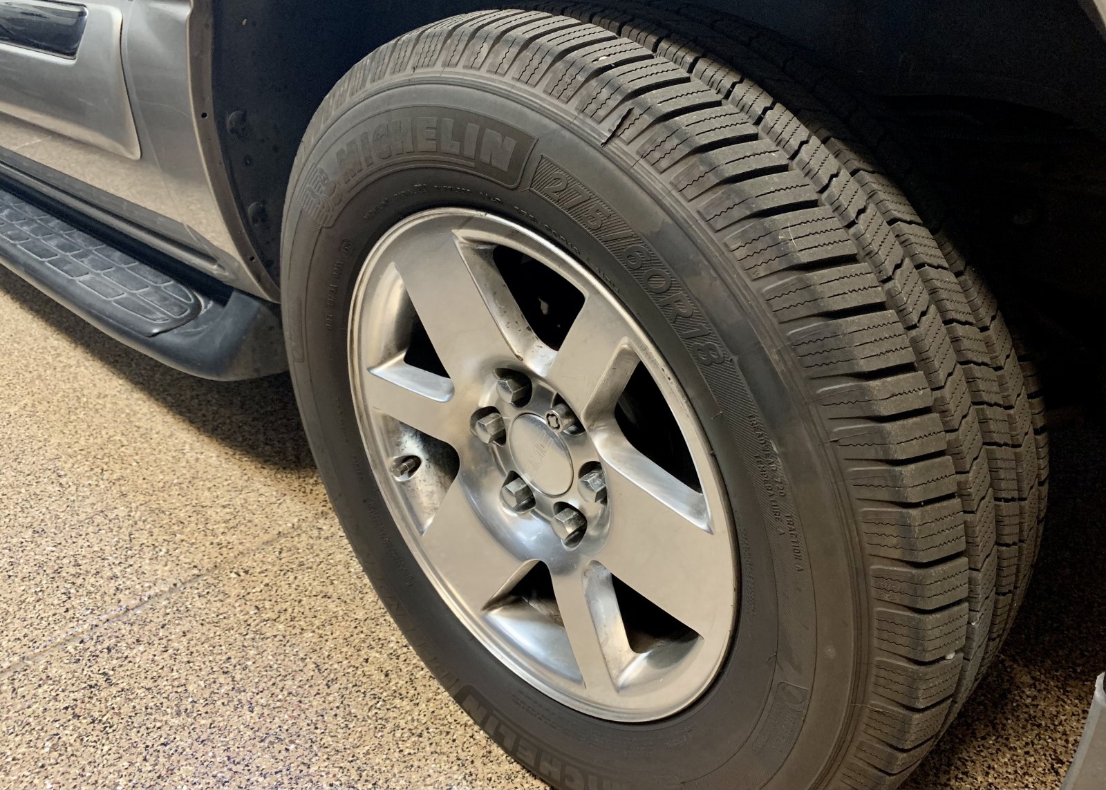

I replaced my OEM 265/70/16’s with 275/60/18’s years ago and it’s been a great upgrade proven over tens of thousands of miles. I got the wheels off eBay for a few hundred bucks, in mint condition. Seller swapped his Denali to 20” rims (maybe 2008?, anyone recognize these?).

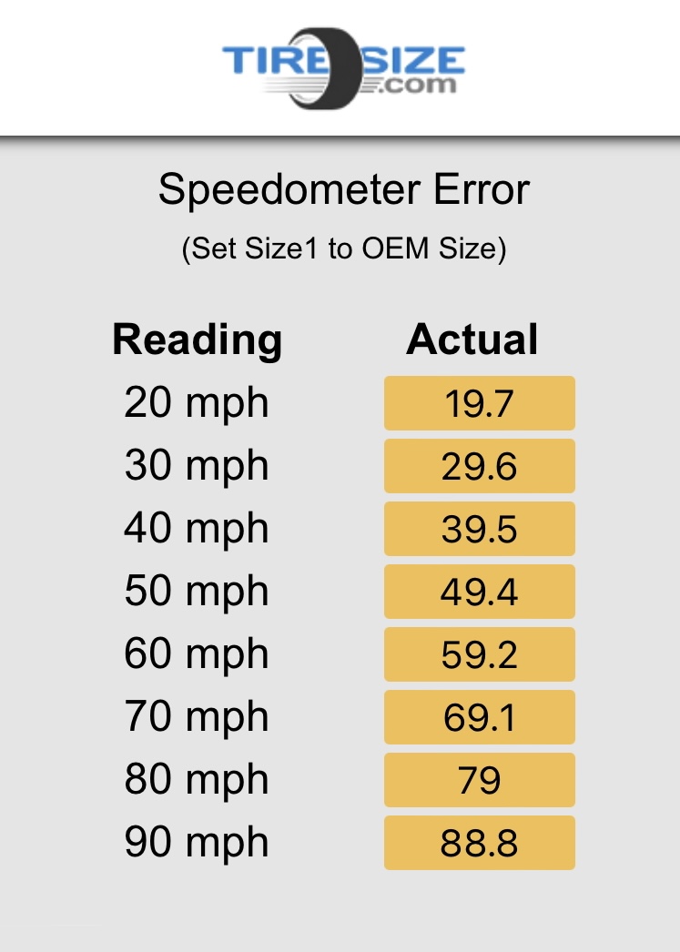

The speedometer reads accurately because wheel diameter is maintained. I’ve checked this with math (online calculators) and also w GPS reporting speed actual vs eyeballing the speedometer. On brand new tires actual speed is about +1 mph speedometer, but after the rubber wears down a few tenths, the speedometer is right on. Even more important is the smooth ride, and better traction and aluminum rim road rash protection from the extra 10mm of width. Finally, the appearance is good - OEM vibe but better.
For GMT800 on a standard stock lift, this is the right setup. Is what I think.

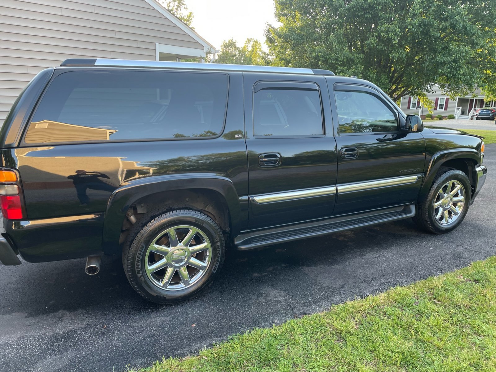

Perfect advice. I run 20 inch 2021 Yukon take offs on my 2006 XL Denali. Though this is my 3rd set of 20s as I’ve made a few change ups. Anyways I followed this advice and went with Michelin defenders on my current wheels in February of 2022 when it was time for tires and I couldn’t be happier. I live in the mountains, I drive in snow 4-5 months out of the year and this year we had record storms of 10 feet of snow in 10 days. And I never once got stuck. Defenders run amazingly on dirt pavement as well as the mild dirt roads occasionally have to roll on up here in the mountains. It never fails the one customer that wants an old beat up truck to get a detail and I show up to a mile long dirt road and driveway where the customers beat up truck is….. dammit…. Lol.
Anyways @SilverSport you wouldn’t be disappointed with Michelin defenders on a 20inch wheel. I will admit though I run a 275/60 size tire and it’s much preferred over the OEM recommended 275/55 size, for my situation.

such a decision for me...the trucks look great on both the 18's and the 20's...thanks for sharing the pics

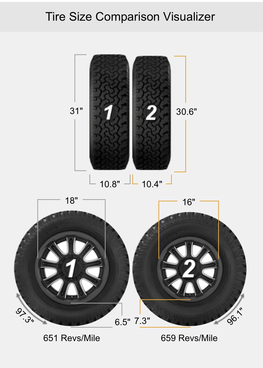

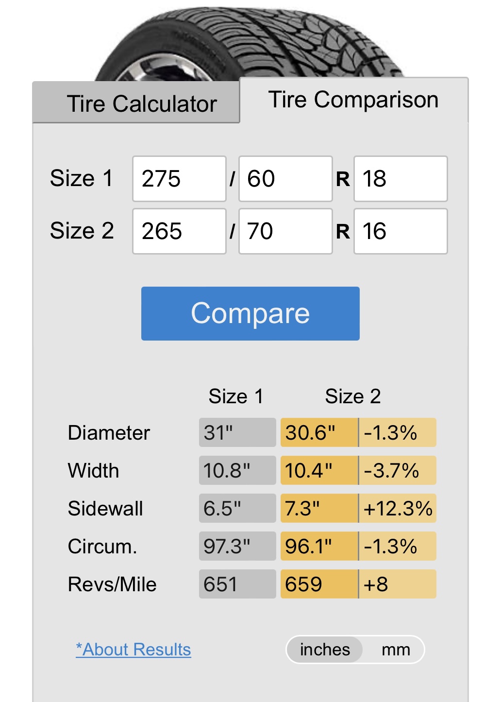

275/60/18 specs vs the OEM 16 on my 2001:
