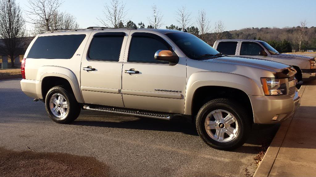

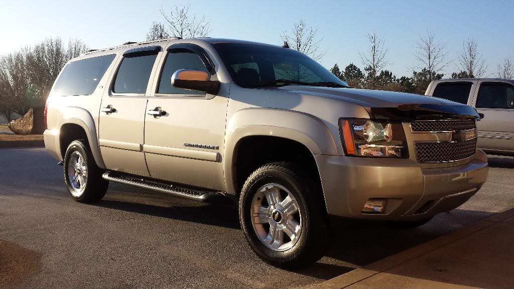

Installed the CCM 2.5" leveling kit on the front. Had the windows tinted, removed the pinstriping, and removed the cheesy chrome fender pieces. I'm really liking the stance. I still need to install the rear 1" spacers that came with the kit, but ran out of time yesterday. Here are a couple of pics of the finished product. It's amazing what a couple of inches does to the looks of a vehicle.

What kit did you go with ? I did 1.5 In the rear and want to install air bags because I pull an enclosed trailer and it sags .

I went witb the CCM 2.5/1.5" lift. I also installed the rear Airlift bags to use when we pull a camper. They work great and I definitely recommend them for anyone pulling weight. Let me know if you have any questions about it.
