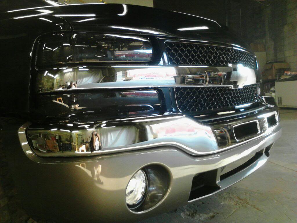

Looks good. And he was smart enough to tape the tailpipe! I can't tell you how many times I've seen paint on there. Cause they were too lazy or didn't think to mask it off.

Yeah he is a hell of a painter. This is his personal show truck he built.

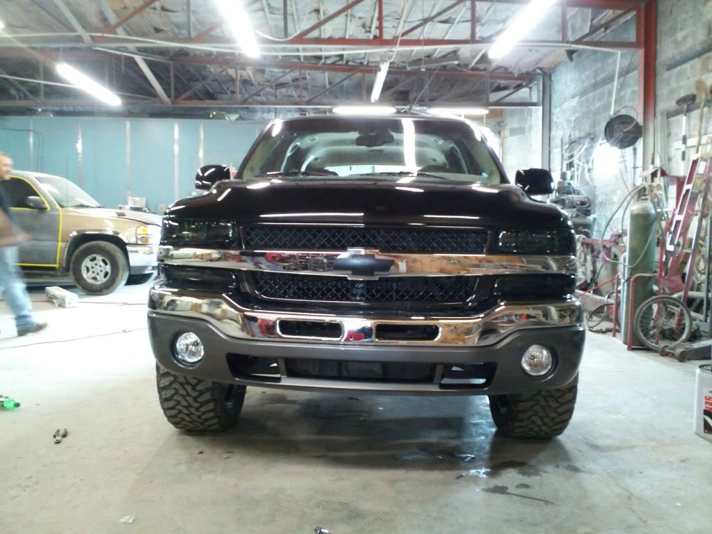

Grabbed this earlier today of the forum. View attachment 74433 View attachment 74434See the dip in the HD bumper. Different then the Tahoe bumper.
Just incase you weren't aware @Tonyrodz, That's actually a '03-'07 classic GMC Sierra bumper.
@derek1387 An '02 HD bumper cap fits on the stock Tahoe bumper, you'll just need to lower the stock bumper to compensate for the taller cap and grille. Or, use your stock bumper cap and trim a HD grille to fit your stock bumper cap and not have to make any adjustments to your bumper mounts. There are a few guys on here have gone the trimmed grille way.

Isn't the Silverado grill the same as the Tahoe grill? Sorry for giving you some wrong info.

On the HD, they mounted the bumper lower and made the grille taller to get more airflow to the intercooler on the duramax trucks. But the base bumper is the same as the Tahoe/suburban/regular Silverado.
