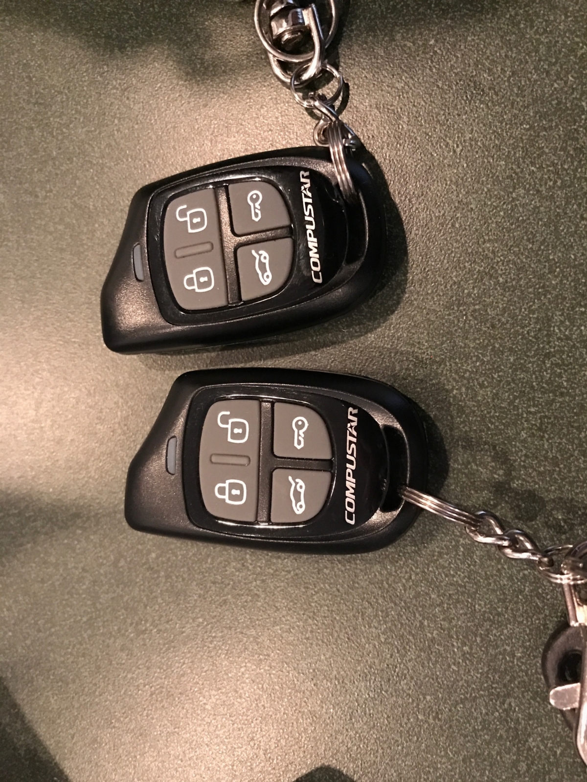

Compustar remote start installed! Works great.

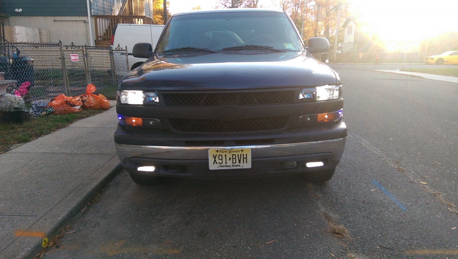

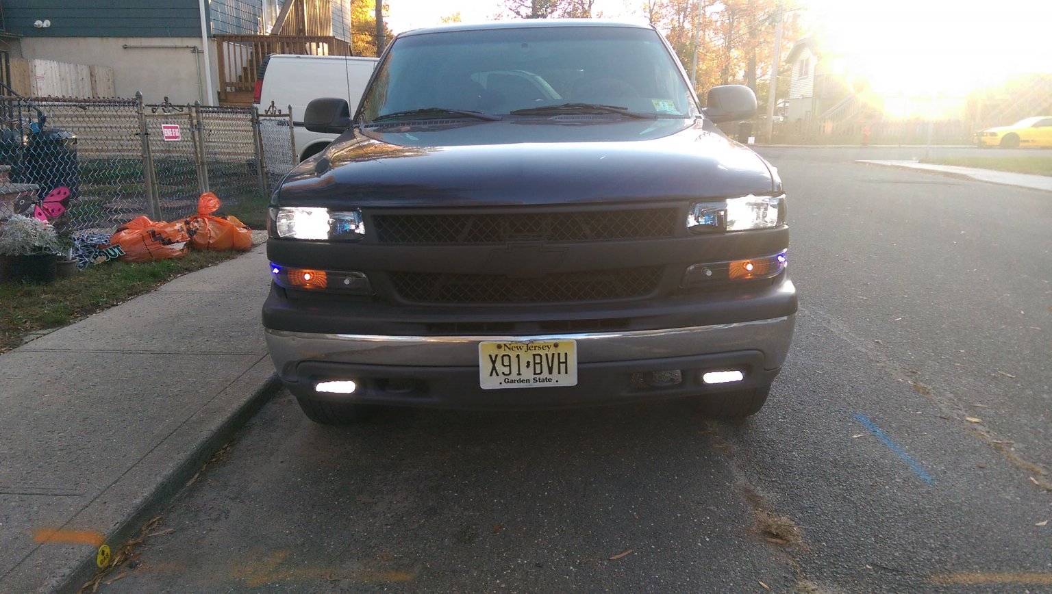

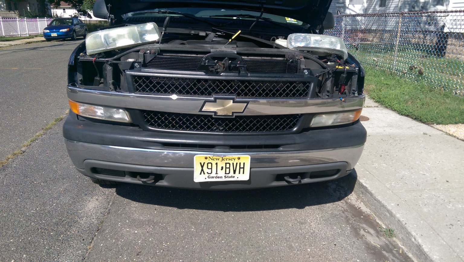

So...next dilemma.
Silverado grill with chrome stripe and paint matched plastic, or all chrome Tahoe grill?
Then i need to order a new lower valence so I can install fog lights. The wiring is there but the air dam has the spots blanked out.
Thoughts?

It's been done a lot but it looks really good. I think you just have to get different brackets. eBay it for the bumper.
If not a Silverado grill color matches with a color matched bumper would look good for probably half the price

This grill came from an 02 Silverado hd. 2000-2002 will work on our trucks. My Hoe is an 03 also. The grills work on 2000-2006. There's a sticky on here for the installation of them. Any questions, fire away!
Yeah I found the sticky for the hood.
The grill one I can't find.
I thought I was reading you had to get a different bumper cap and lower the bumper or something.
If anyone has the how to or sticky...that would be awesome!

If you go with the stock Tahoe bumper and cap, you'll have to trim somewhere around an inch to inch 1/2 off the bottom of the hd grill. If I remember correctly if you want to use the hd cap and bumper you have to reweld the bumper supports, but I don't remember how much. I'm sure someone more knowledgeable will jump in. Have you tried to do a search on the hd front end conversion? Lots of threads on here about it.
