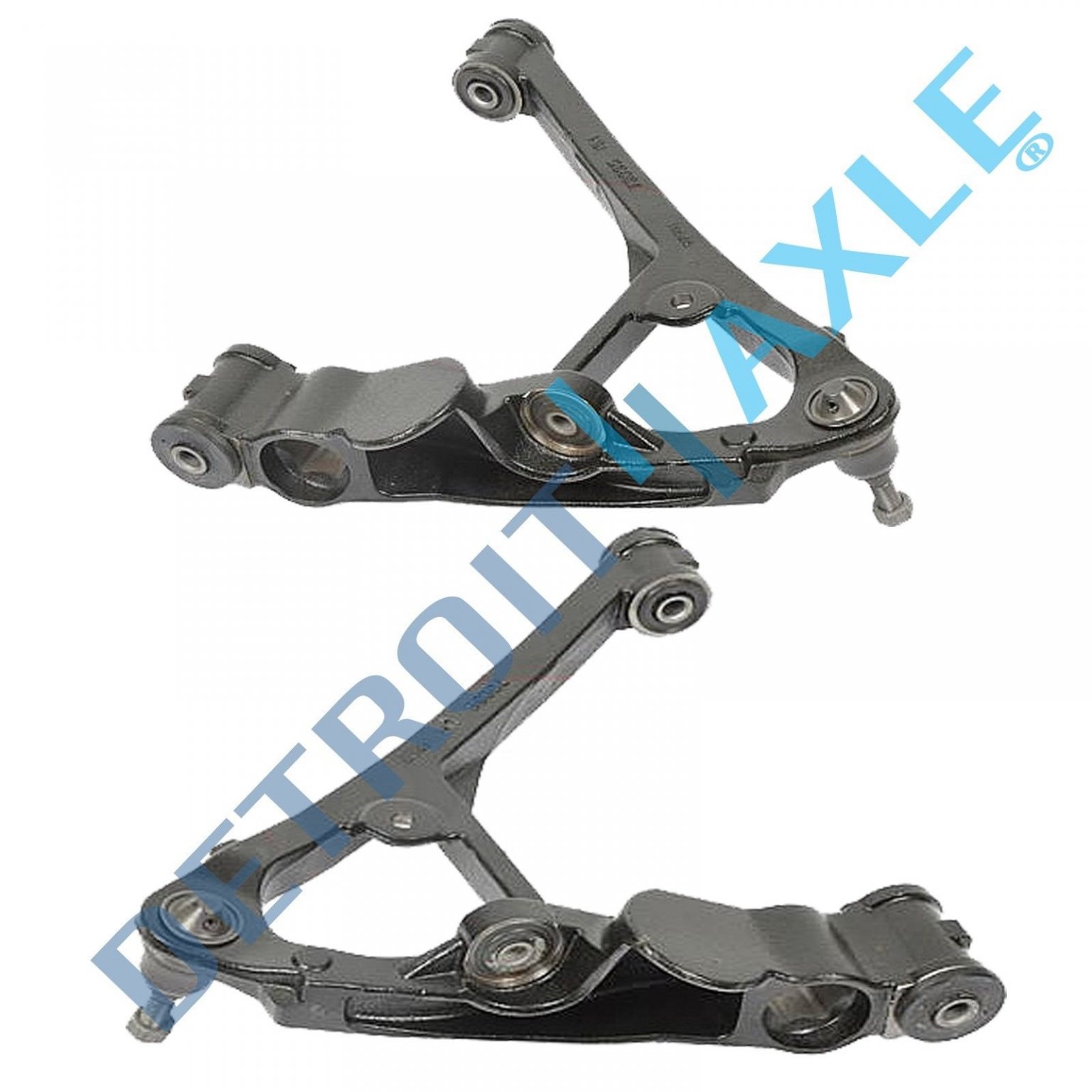

Okay still getting used to my first and new (to me ;) ) 2000 Tahoe. One thing I quickly noticed was that In my attempting to do a service today (new upper control arm, sway bar link, inner outer tie rods an of course lower ball joints) I noticed that my lower control arm balljoint look like it cannot be pressed out. There seem to be a metal ring around the ball joint that would keep the balljoint from being pressed out. I heard that there are some control arms that is permanently pressed and would require a whole new lower assembly.
I have a feeling I know the answer to this question so I will just need confirmation.
Here is a stock photo
I can't pressed this out can I?

it presses out the other direction. That is the top of the ball-joint. They press up from the bottom.

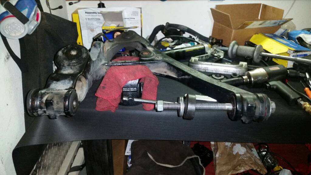

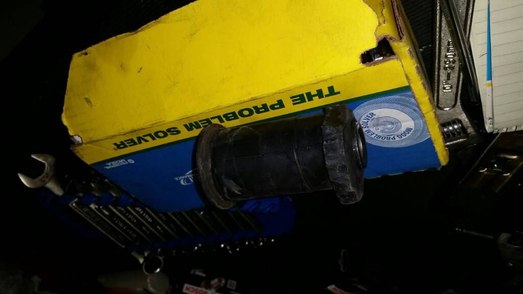

OP, if you haven't done the ball joints I highly suggest just buying new arms. I pressed out my old ball joints only to find I still had a problem with my lower control arm bushings.
I managed to press out the old bushings using a ball joint press start the bushing out and a slide hammer to pull it the rest of the way. I rigged up a tool to press the new bushings in. It would have been a lot easier and less time consuming to just put new arms in. Here is my makeshift bushing install tool made out of a 5/8×10 " bolt and nut washers from Home Depot with a part from a ball joint kit. My time was worth more than what I saved lol..
The good is I now have all moog parts on the arms so it can be done.

My lca bushings had started to Crack on the edges. When pressing them out I grabbed the edges with some vise grips and big chunks broke off. There was obvious play in the center section of the bushing too where the bolt goes through. The exterior of the center section however looked new. I think the feeling of the tires not balancing is coming from this slop especially with bigger wheels and tires.
I know that weird wet noodle feel when backing up and the wheels feeling like it is about to fall off is gone as well as when I would uturn. It doesn't pop when I backup with the wheels at a sharp angle anymore either.
