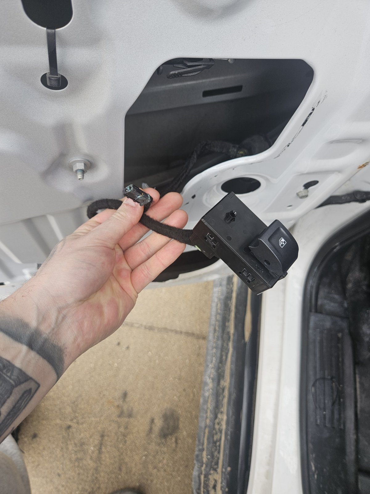

2019 Tahoe PPV, Rear windows are inoperable from front and back.
Has anyone figured out how to fix this?

I just found out the issue on this today. Pull the door boot off. Trace the brown/white wire through the connector. It will be missing on the other side (inside the car)
This is the BCM reference wire. The switch has nothing to send back to the BCM without it.
I added a new wire, I still have to run it to the front door boot and tie it into the brown/white reference wire there.
I’ll update you when my windows work later this week.
