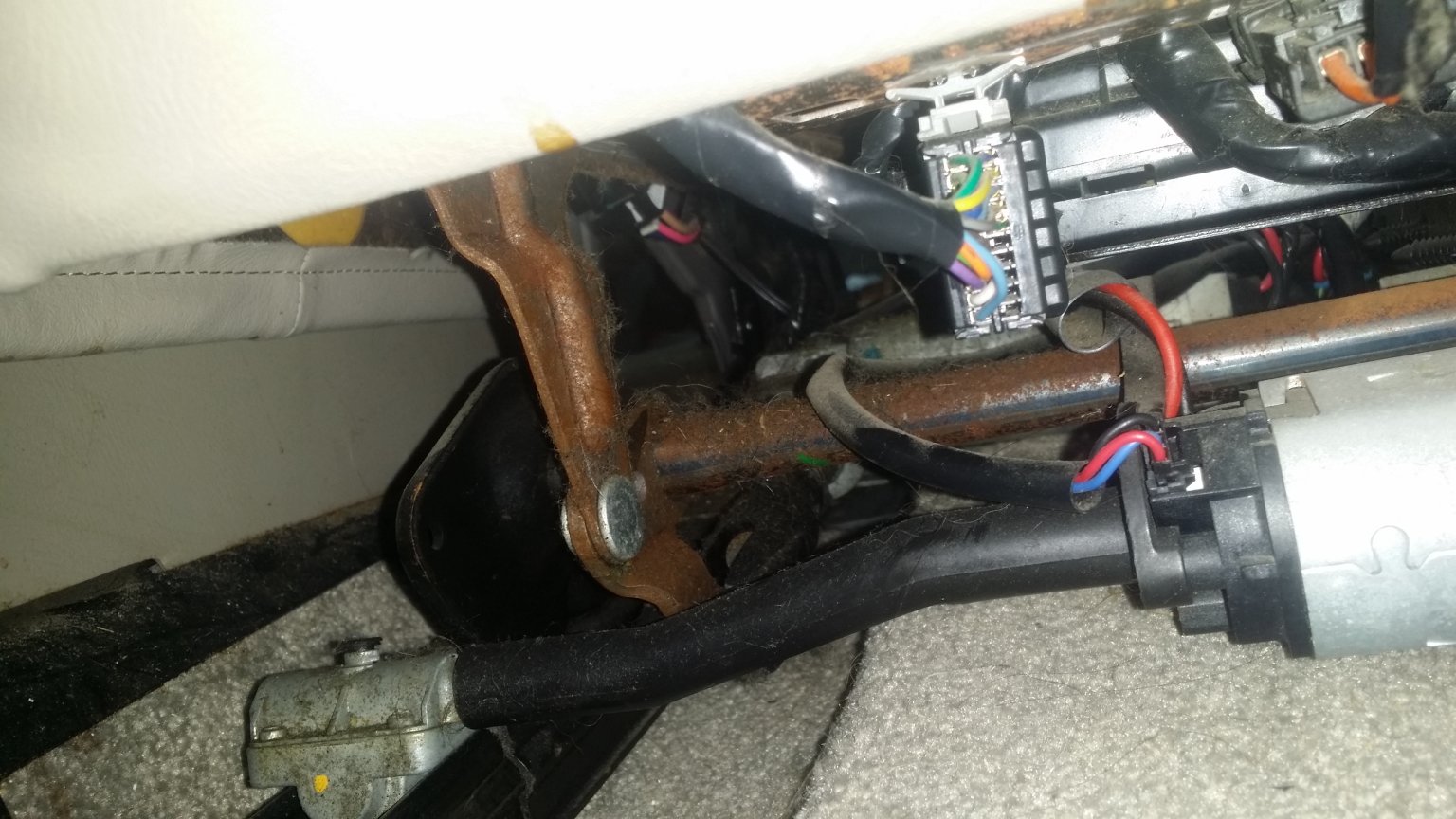

Update for anyone else having a similar problem
I wiggled the motor while activating the switch and the rear side of the cushion now works.
Now I just can't get the front side of the cushion to raise. Press the switch and I hear a click.
Maybe the front side of the cushion and rear side of the cushion seat work on different motors but the wiggle trick worked making it somewhat better to drive but just need to figure the front out and I'll be set

Mine 2004 Denali had the front tilt stuck in the lowest position. I was able to unbolt the jack screw, manually raise the seat up to the highest position, unscrew the jack screw to accommodate the new position and reinstall. Seemed the motor had thought it reached its high limit (sensor by voltage). Anyway, that did it. Easy enough to try.
