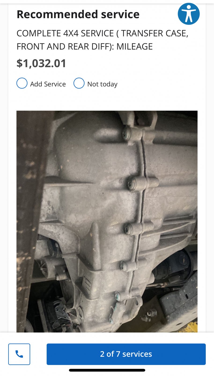

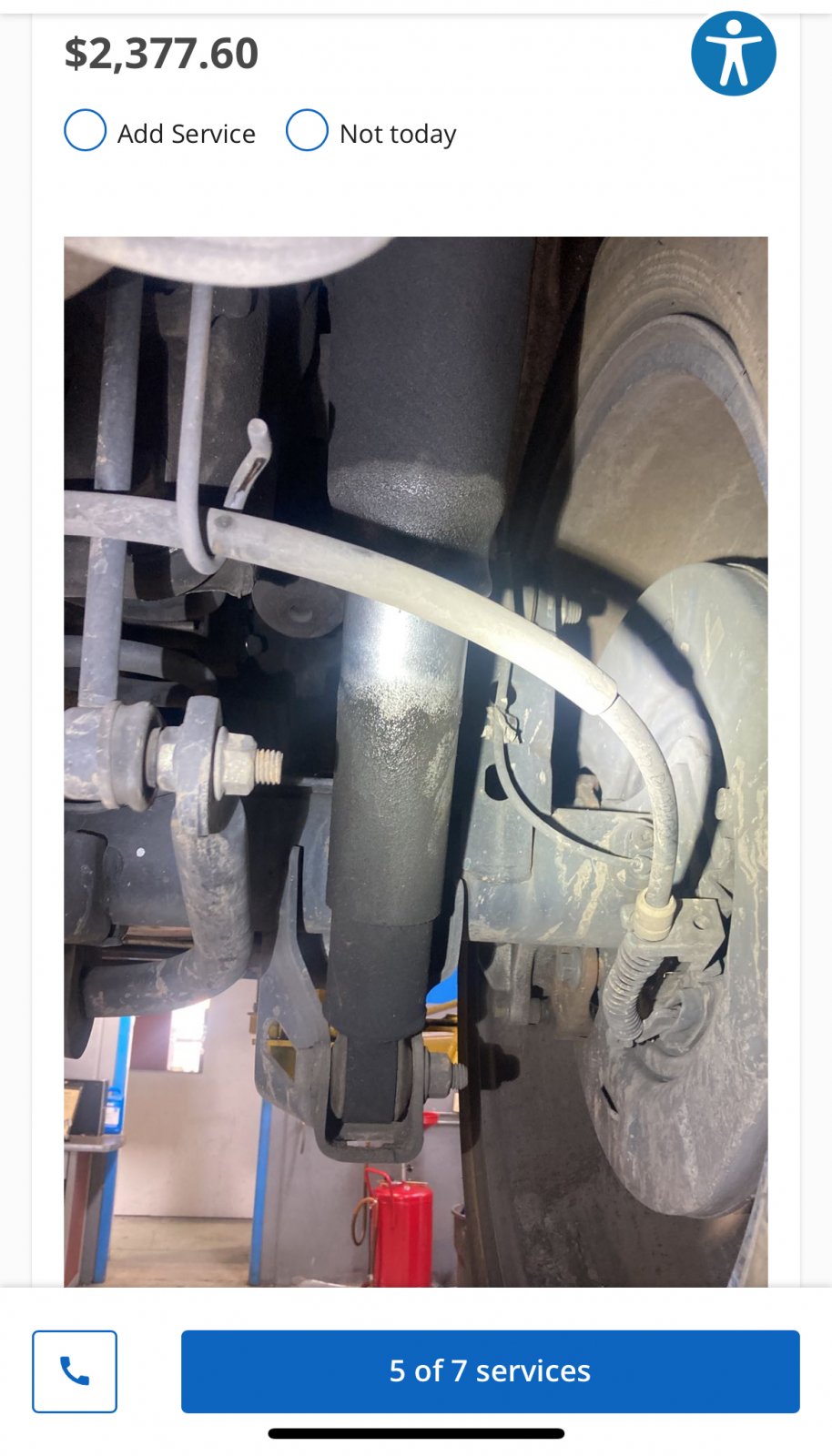

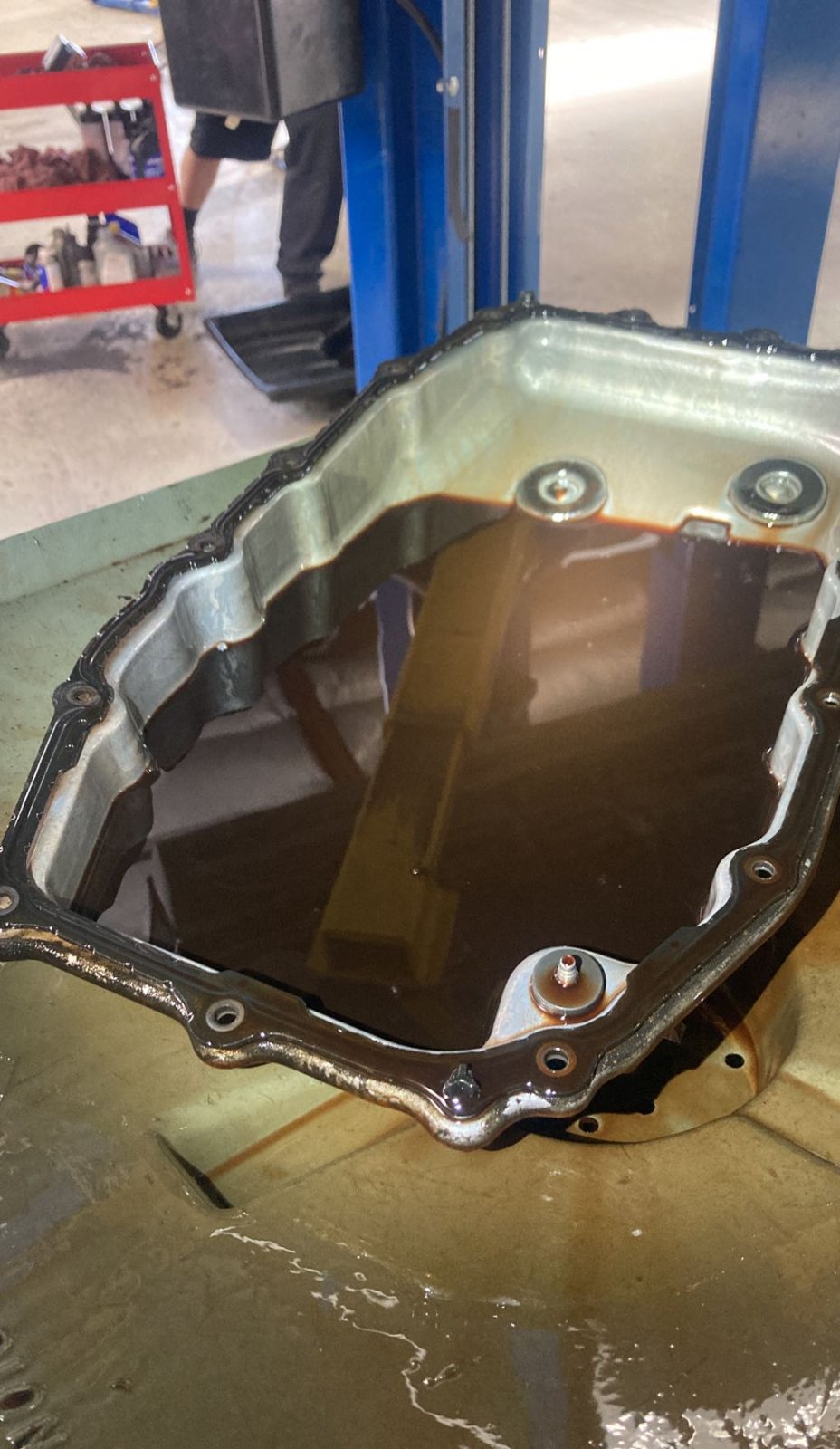

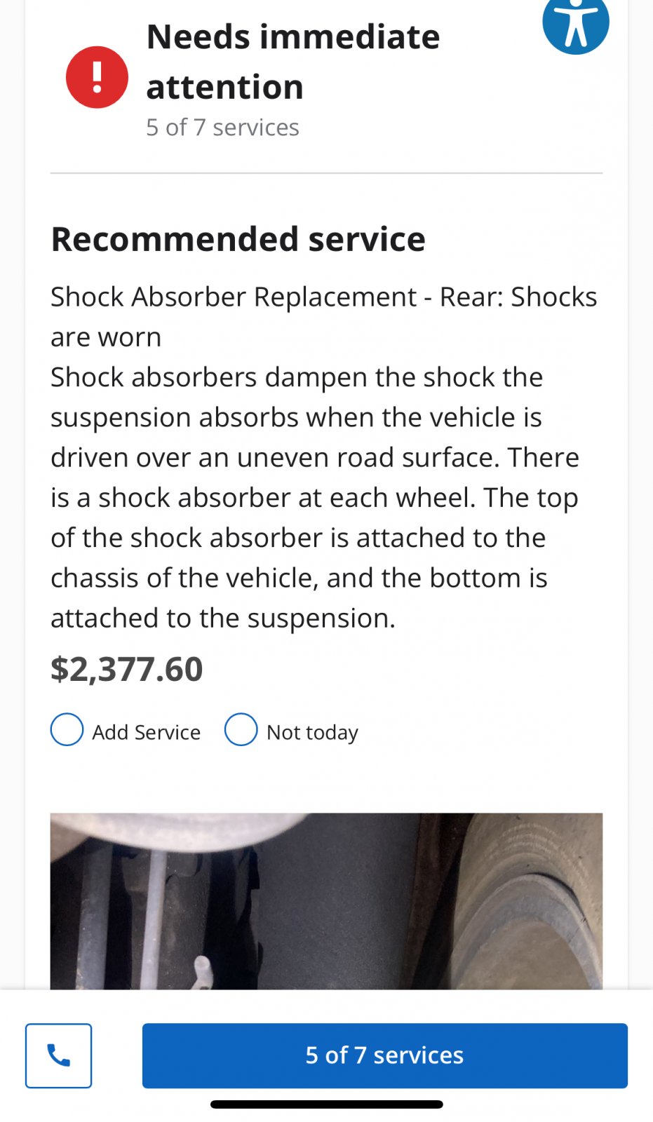

Dealership sent this to me. They said the fluid was dark and had a slight amount of metal in the pan but was “normal” and didn’t give them red flags that the trans or TCC was going out. They are flushing now.
They did also say I need a full 4x4 service with fluid changes and that my rear shocks were blown but I’ll look at doing those myself lol

GM_Josho
Jun 20, 2024
I agree. The fluid looks dark for sure. From what I can see the magnet doesn't look bad at all. You could change your shocks yourself, even with little mechanical skills. Once you get your vehicle back, watch your transmission temp gauge. I don't recall exactly what normal is, but I believe anything over 200 could indicate issues. Sounds like you may have caught it in time though!

We’ve been driving it for a few days now and haven’t felt the issue come back after the flush. I’m still trying to research if I should still add a bottle of that LubeGuard product to the trans or if the new fluid type is sufficient.
For the shocks I was starting to go down the rabbit hole of OE or aftermarket because of the huge price difference but my wife had the good idea of contacting the third party warranty company and seeing if they would be covered. Waiting on the call back from the dealership who has to work with them directly for confirmation but if covered I’ll gladly have them install the OE ones.
GM_Josho
Jun 20, 2024
I second this decision as well! Its hard to say what some of those warranties will and wont cover. Best of luck!
Jul 27, 2021
78
85
HOLY SHITBALLS!! $2377 for 2 SHOCKS?!?!?? I changed ALL 4 for ALOT LESS than that. Arnott all the way around.
J
Jake707
Jul 14, 2024
91
60
Fairfield, CA
yea, with the dealer price of almost $900 a piece plus tax and an hourly rate of probably $150-$200 an hour I can see how it adds up quick. The warranty company is even questioning the quote and requesting aftermarket parts be used, but I am going to push back on that if I can so OE stuff is used.
