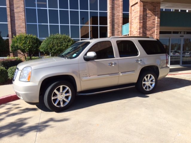

I have searched for a while. I tried not to clutter with a new thread, but the results that have been generated by my searches (Denali leveled and Denali leveling kit) are so vague and I have only seen 2 that are relevant. Most are people asking questions about leveling their Denali's and no pictures.
I would like to see some pictures of 2007-2014 Denali's (or Yukon's with Denali rims) with any sort of leveling kit. Not lifts over 3" (or lowering kits) - Not that I don't respect your creativity and taste. And I really want to see some comparisons next to stock if available. I am trying to get some sort of idea of what mine will look like. I have a noisy front left shock (2007, 94k mileage) and plan to level when I get the front shocks/struts replaced. Any recommendations on replacement shocks (I have autoride of course) are welcome too. This is my first post. So I will post a pic of the ride to start. Look forward to sharing my progress.

Not many leveled denalis on here so good luck finding pics. A simple strut 2.5" spacer up front and 1" rear coil spacer will work fine with auto ride. If your replacing shocks then get Bilstein 5100s and some resistors to get rid of dash lights, also pull compressor fuse too.

Thanks for the advice. If I just want to do 2" in the front with nothing in the back will that work too? or will that some how interfere with autoride? I don't know if the lack of pics of leveled Denali's is good or bad? I think good because it will be something not many have done, but bad because it wont look right? I like the idea of a slightly more rugged Denali is cool. I think BFG a/t is about as aggressive as I will go. opinions?

My 07 avalanche ltz had authored so same height as the denali. Did a 2.5/1.5 level on it and it sat perfectly level. My Yukon is leveled on denali rims but its 4/3.
