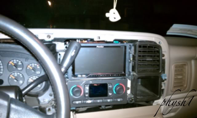

I'm not sure how I missed this thread...the 4200 was the first thing I did & I also installed the avic u220 nav unit.

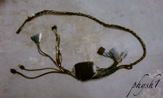

Harness I did with USB cable, nav cables, & bypass relay integrated...
4200 installed...

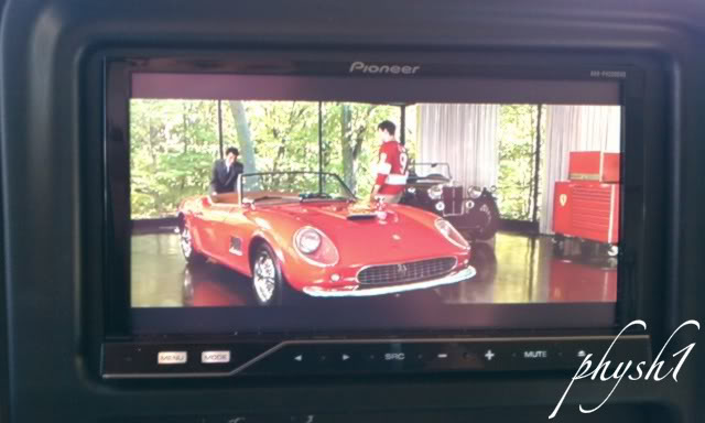

Movie time...

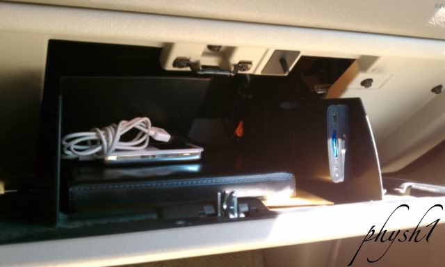

AVIC u220 Nav & iPod in glove box...
