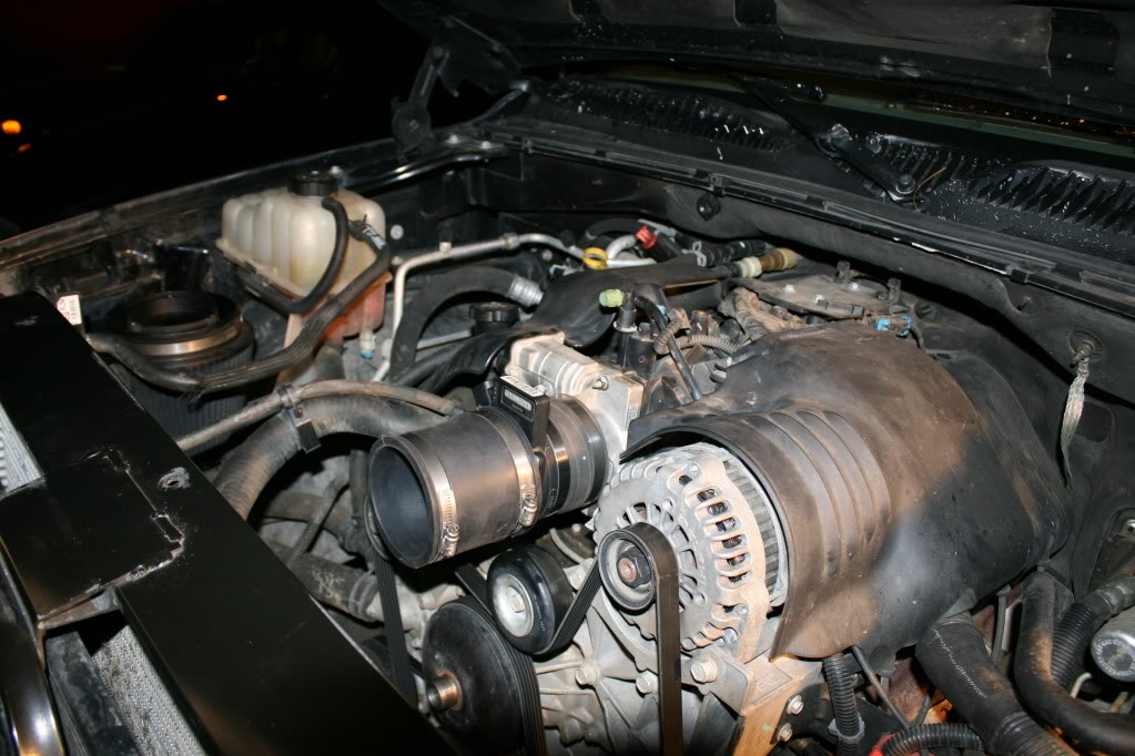

I know this is a bit LONGER then my K&N tube, but I believe the true COLD air will outweigh the length issue
Home Depot Project Supplies
Throttle Body --> Coupling --> MAF --> Coupling
Throttle Body --> Coupling --> MAF --> Coupling --> 90 Degree Elbow

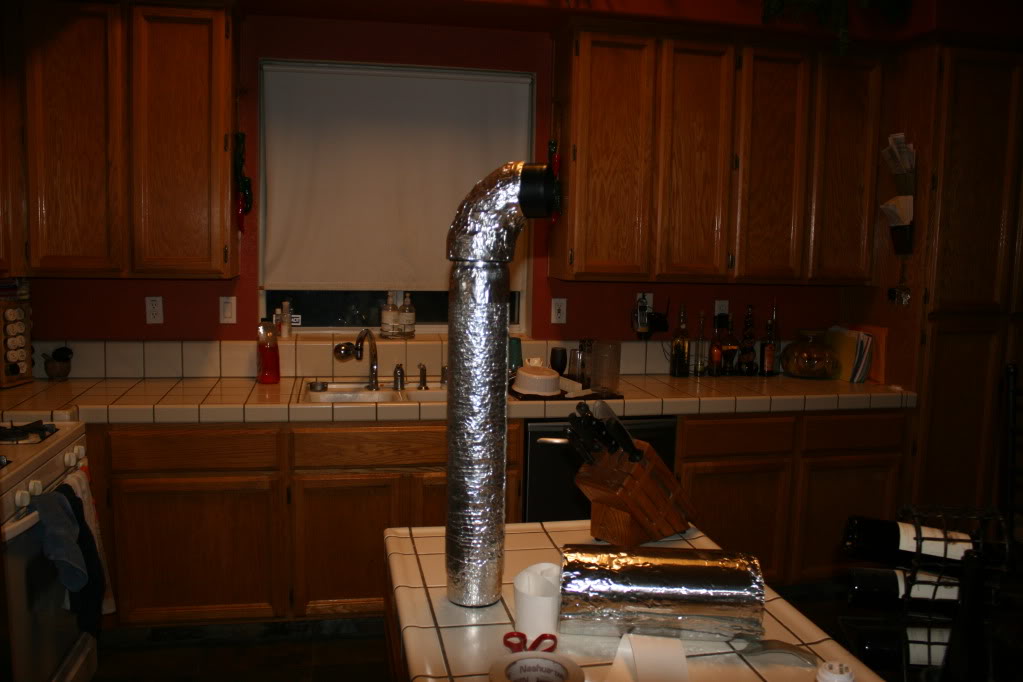

Insulating the elbow then wrapping in reflective tape
Both insulated parts put together
