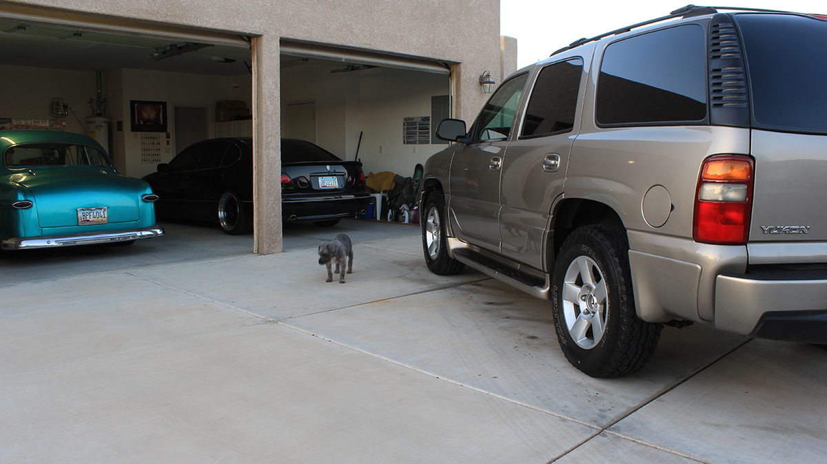

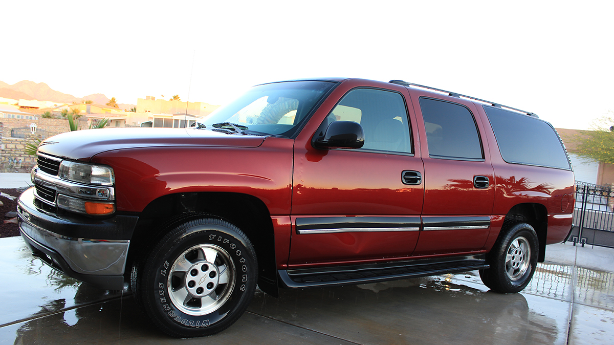

Here's the Suburban i sold. It only had 53,000 original miles. Which is why i got 6000 for it.
It's amazing you can take this little stack of paper and turn it into a vehicle that was once worth $50,000 :)

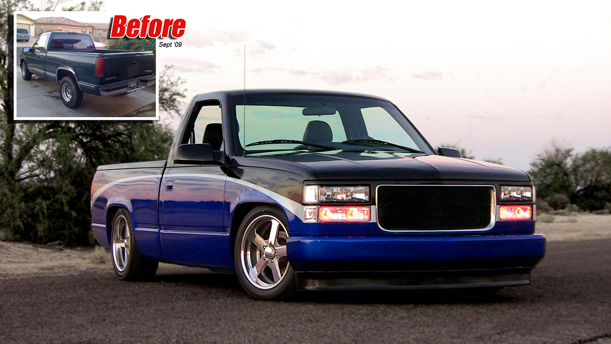

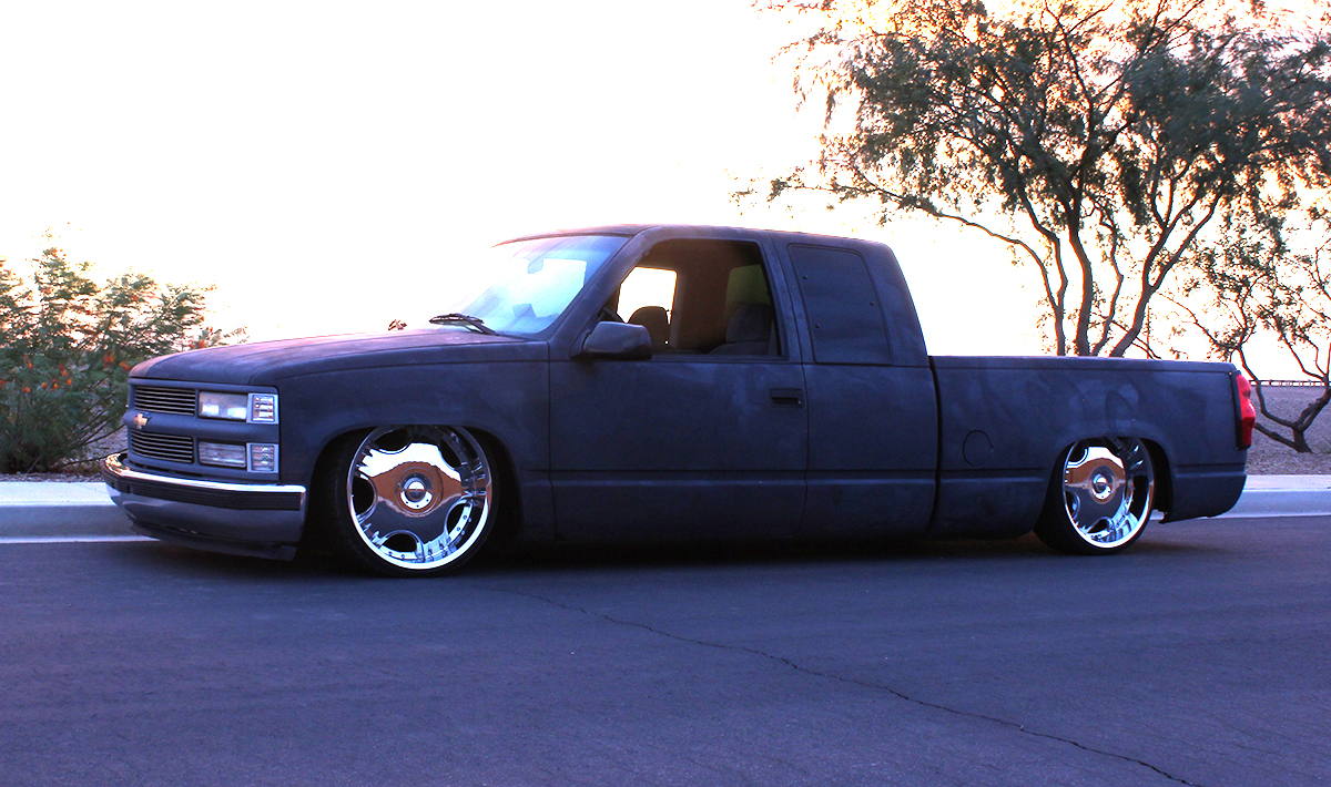

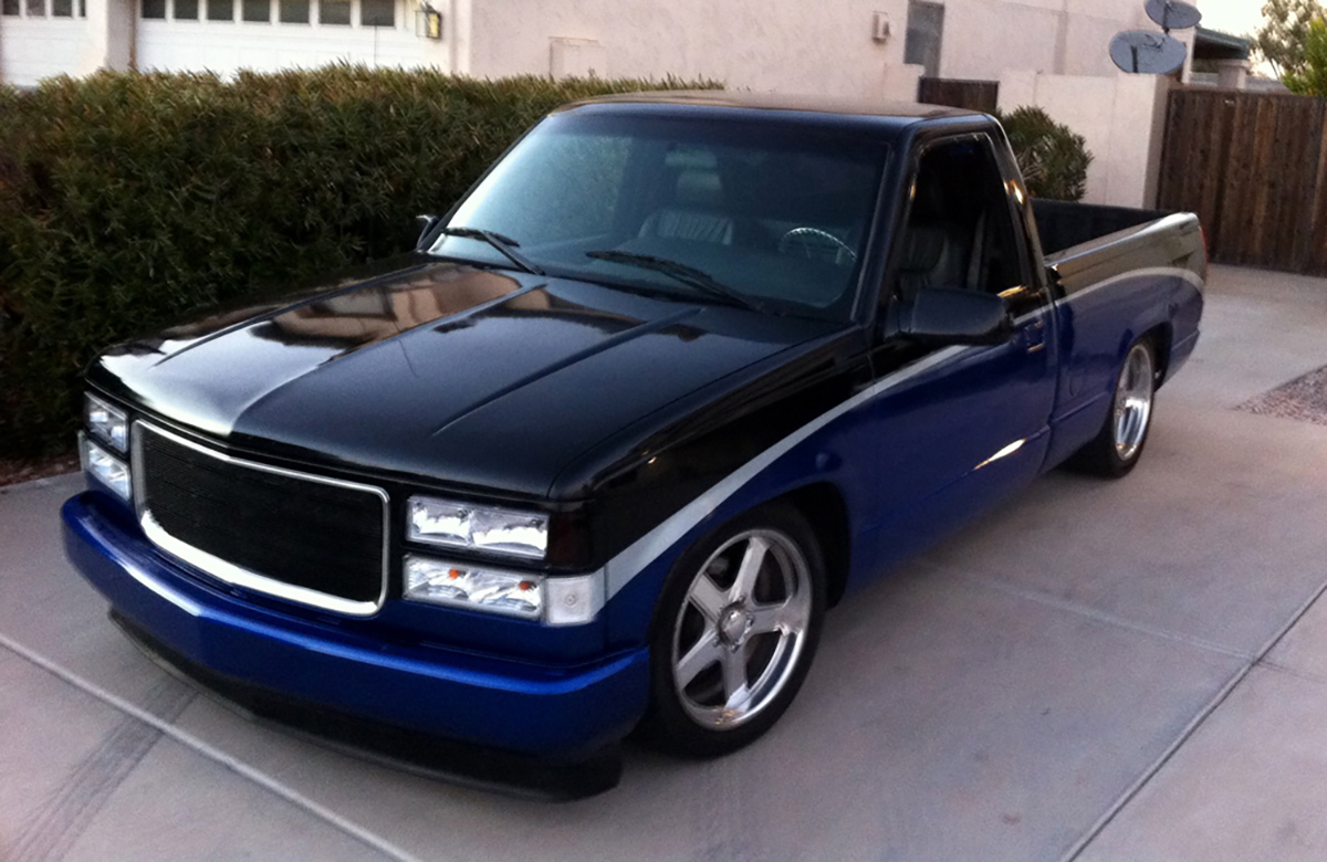

Here's a few of my older OBS builds from the past
2000 Tahoe Limited
1997 fast bagged Silverado
1995 GMC Sierra

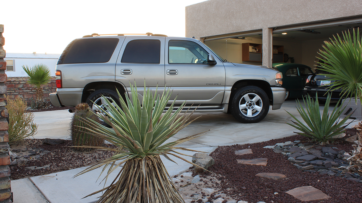

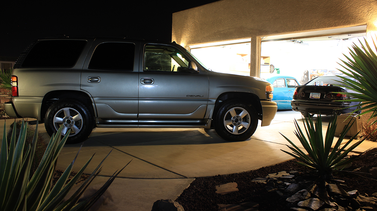

The Denali is in great condition. It has a few issues, but that comes with the territory - 195,000 miles on her.
It's previous owner was a snowbird from Canada. I guess it sat in storage for the last 3+ years here in AZ.
Cons:
  • Almost all the fluids were low and needed basic maintenance ✓
  • Needed a new battery ✓
  • Probably the Only color i don't like of the Denali's
  • The front bumper feels a little lose and wobbly on the lower part.
  • The dash cluster gauges dont light up at night, but everything works (information center etc.) ✓
  • None of the front speakers work

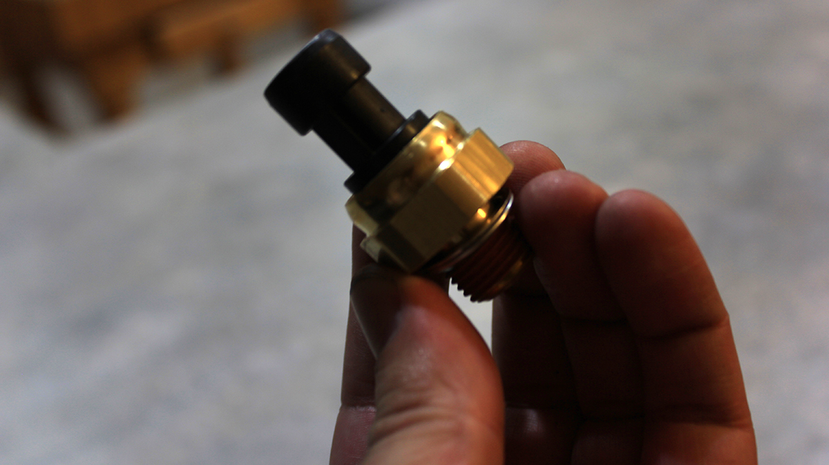

  • Needs a new Oil Pressure Sensor (gauge reads 0 or 80 always) ✓
Got the OPS. Just need to put it in. I heard these are a common problem in the NBS?
Anyone replaced it on their 6.0L yet? Let me know if you have any tips.

I did mine but the intake manifold was off so it was a piece of cake. You need the special socket because a regular deep won't fit over it and unfortunately you'll have to do yours by feel, kinda like spark plug #8.
ahh, cool. yeah i saw vids but they were all with the smaller engine. everyone says you need small hands and a mirror or something. I haven't even torn the covers and plastics off to see it.

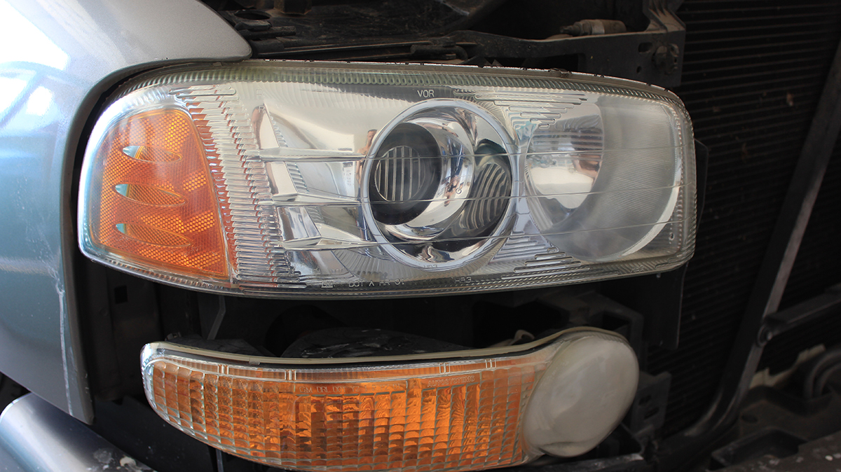

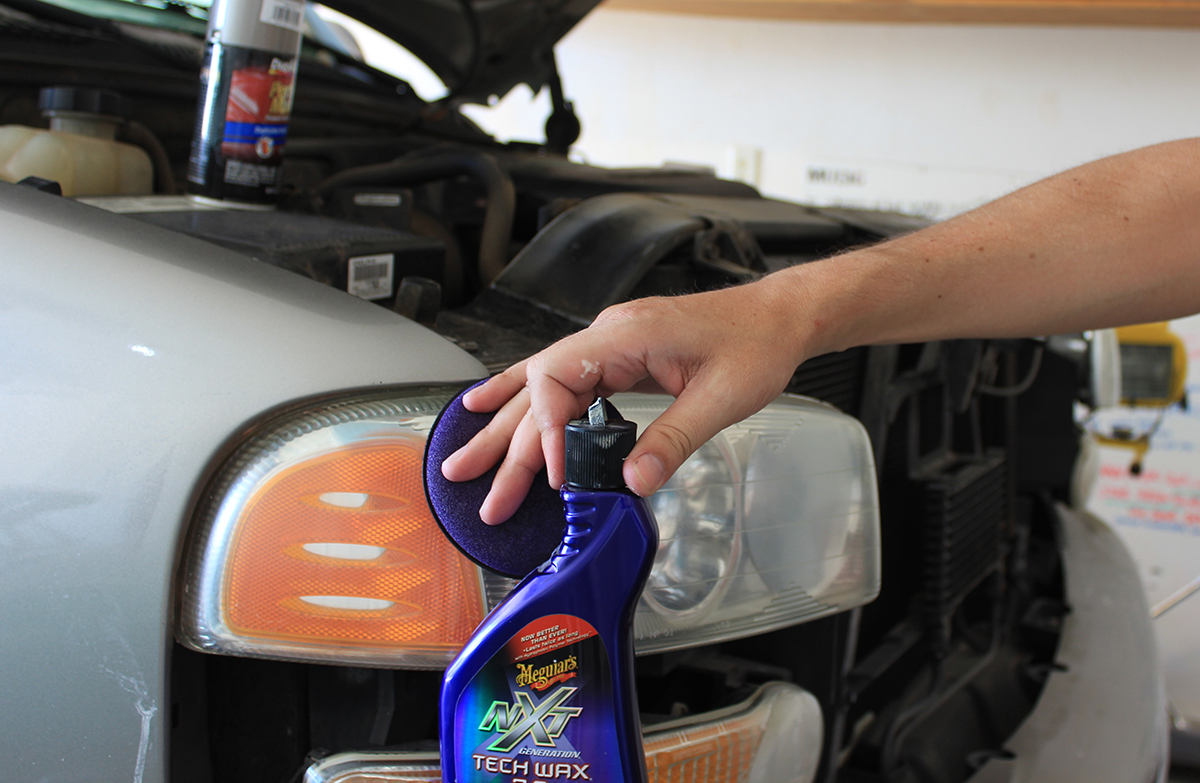

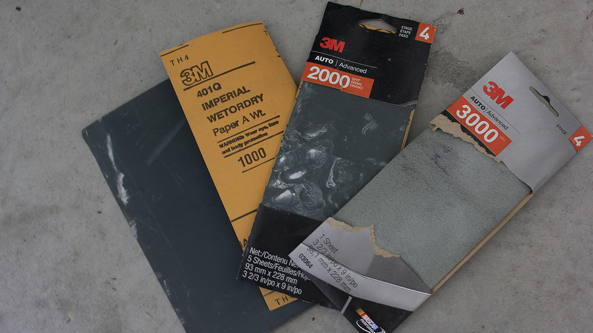

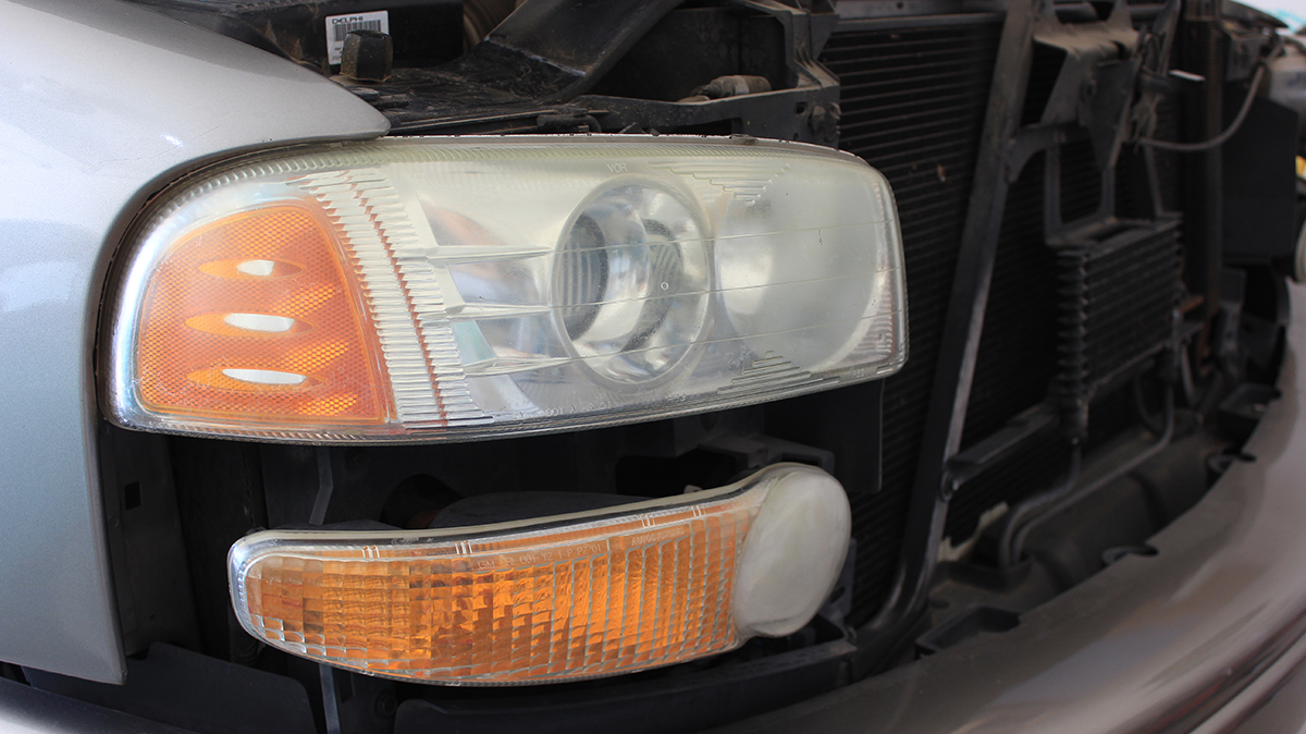

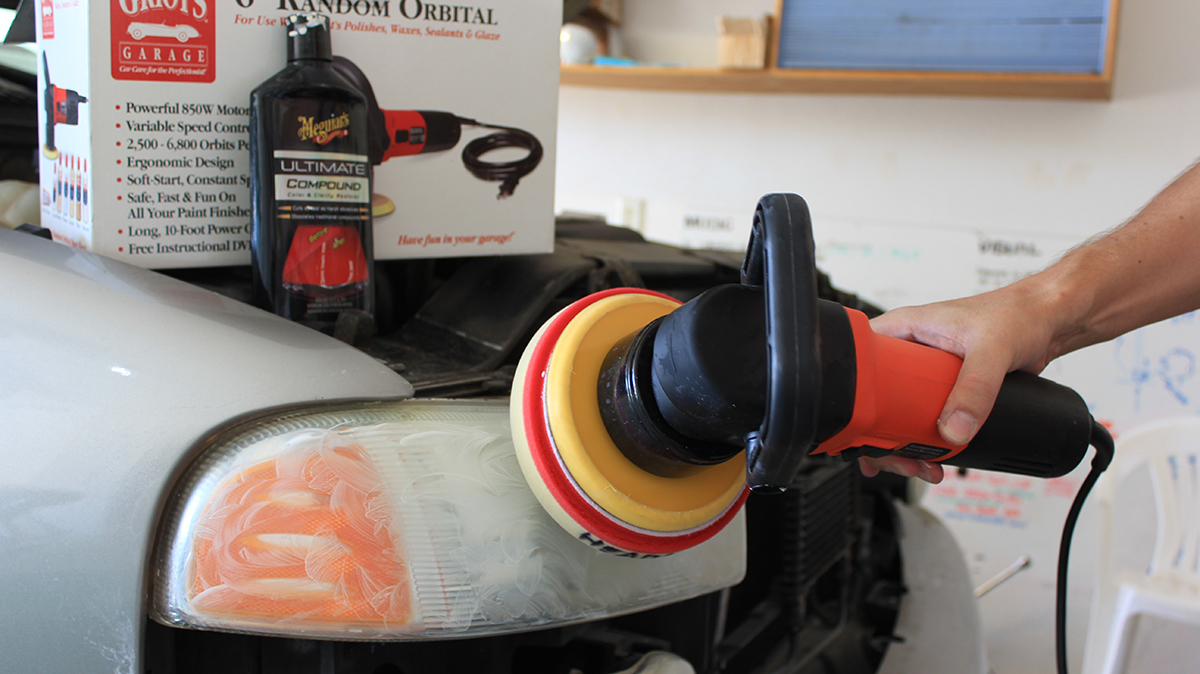

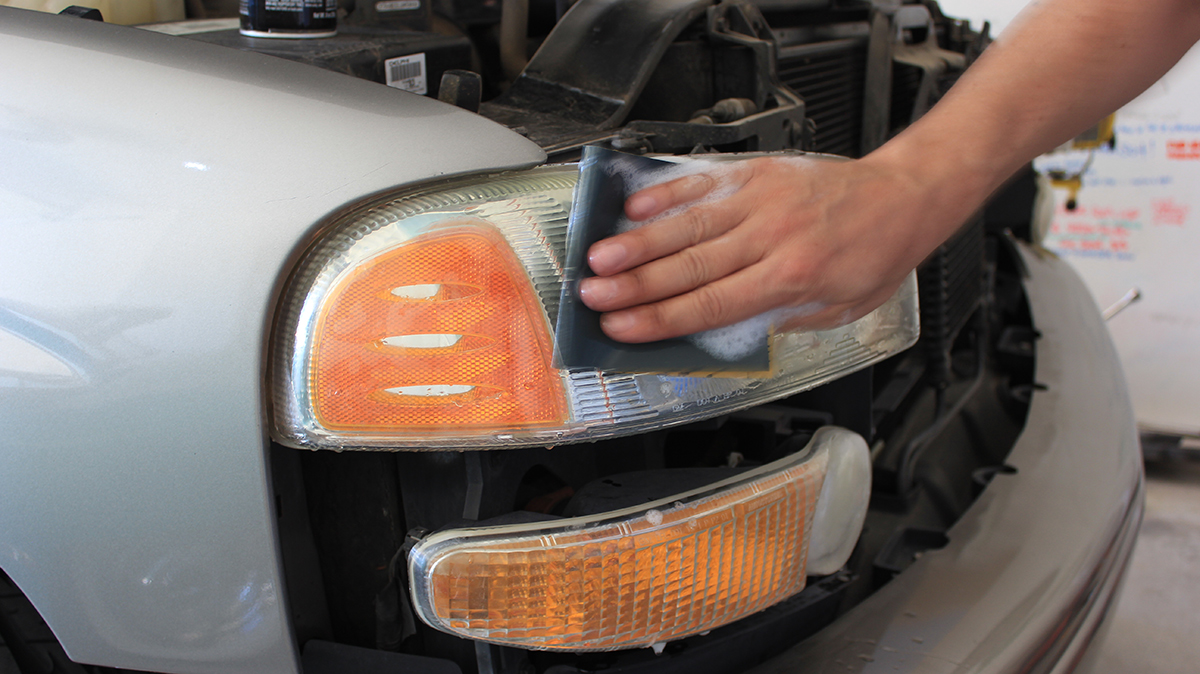

Basic stuff: Faded Headlights
Wet-sand. Soapy water and 1000grit, then 2000, then 3000/trizac
Buff out with Ultimate Compound and the Griot's Garage Orbital on 6
Wax
Done
The white boobs :) on the lower turn signal are really bad. no hope for them. Probably replace them anyways

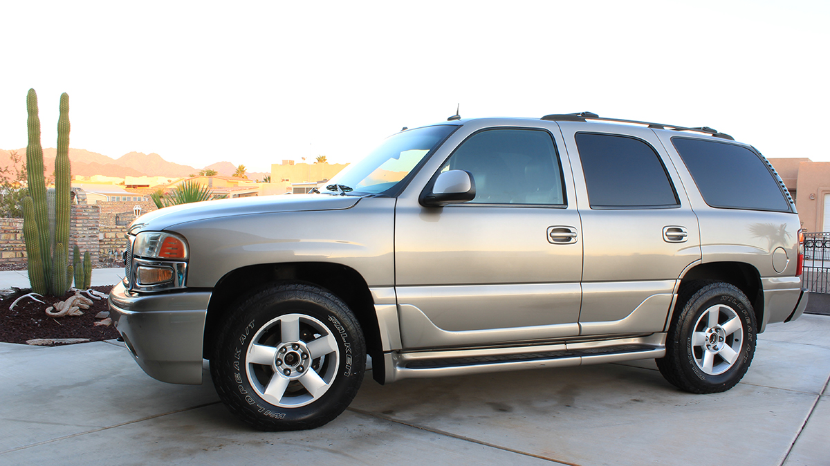

Which wheels are those? Nissan?
Wax
Done
Those headlights came out great. Did you clear them? If not, they're gonna get hazy again.
nah, no clear. the wax at the end usually helps em last longer. I am sure they will get replaced before they get faded again though.

Not bad what kinda rims are you thinking?
man, i swear i have mocked up 50 different wheels in photoshop. and the one's that look the best to me are the common Boss 330 / U2-55 wheels everyone runs. Everything else just looked cheap or too flashy or too much chrome. I would love to have a set of Billet Wheels made but thats $750 a piece each wheel. I can't justify paying $3000 for wheels on a vehicle i paid $4000 for haha

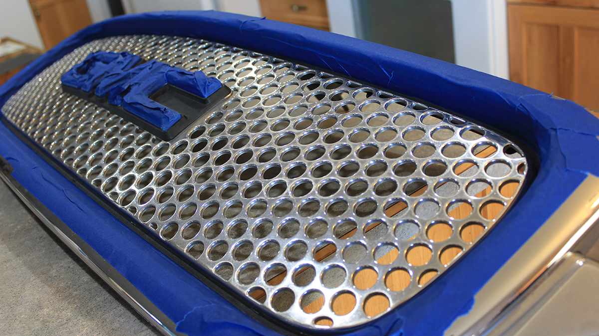

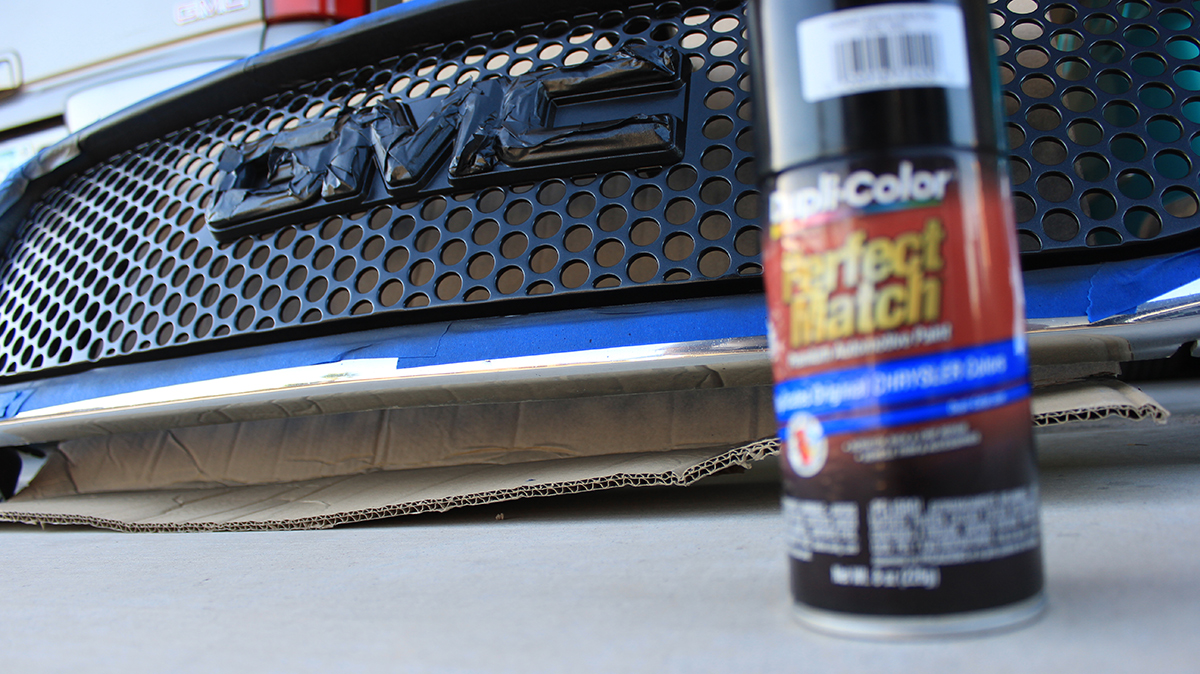

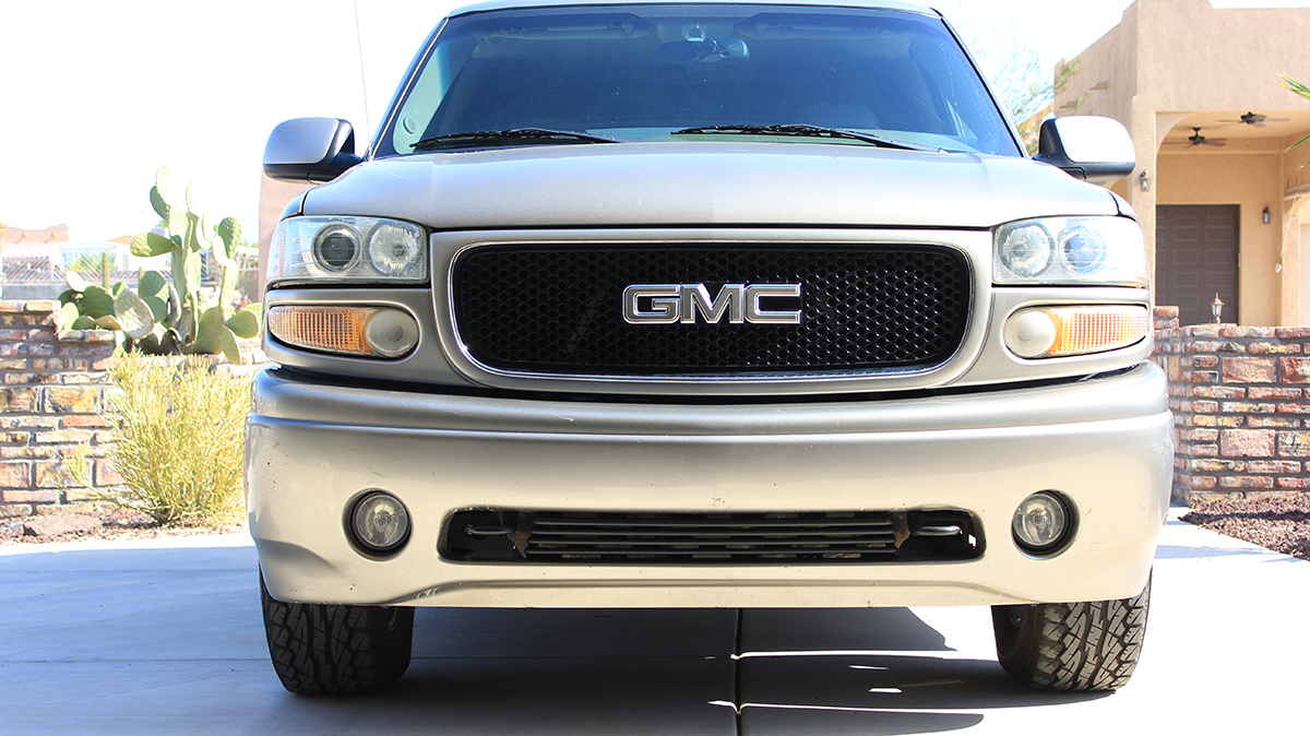

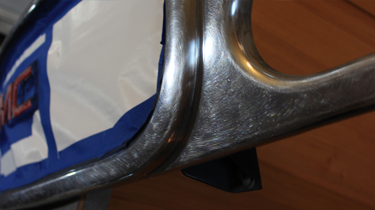

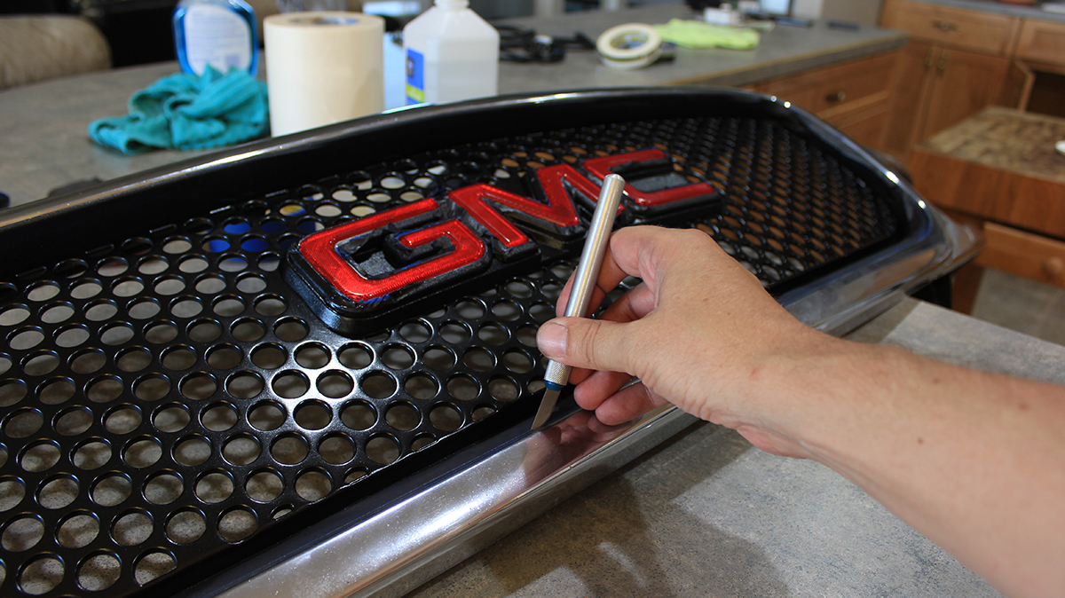

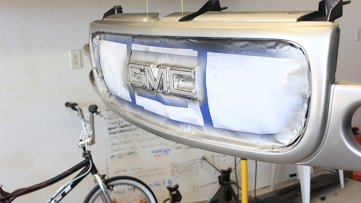

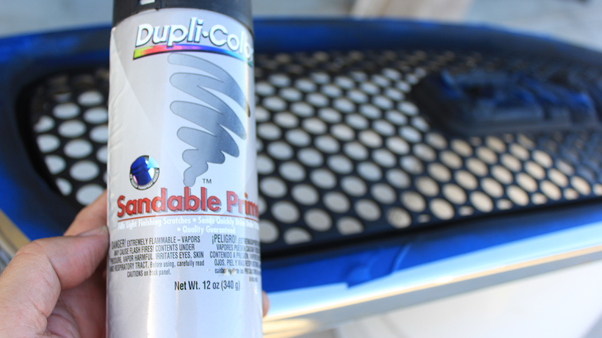

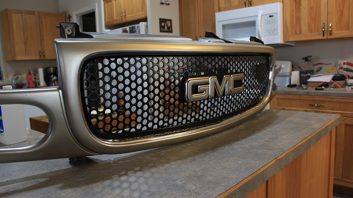

Project color match front end
I like chrome in small amounts as an accent, but this front end has way to much chrome going on for my taste.
Took it off, cleaned the hell out it then got to sanding and scuffing.
To get the paint to stick to chrome i had to start with a 200 grit.

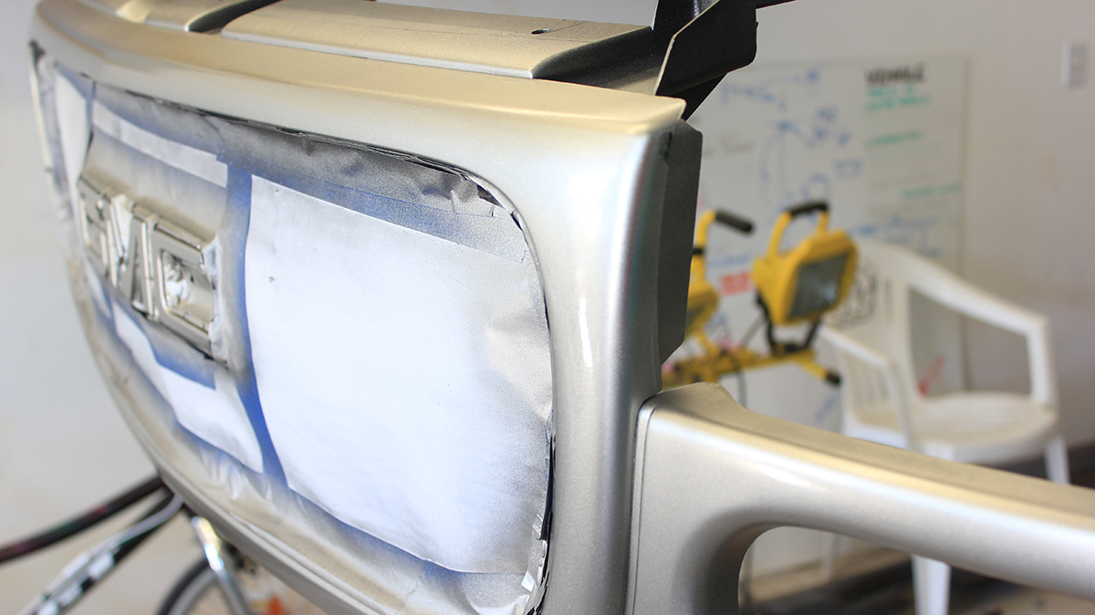

I didn't want to have to retape everything twice so i had to do this methodically
2 coats of sandable black primer (which btw is a pretty good match to the black plastics on the denali)
2 coats of black pearl
(i didnt want the center gille too shiny so i opted out on the clear coat on the black)
I wanted to use the OBS Sierra style of chrome grille surround style.
Confused yet? this is why i taped it the way i did.
If you look close the grille surround has a very small lip that goes around it.
I ran the butt of a spoon into the tape along that crease to give me a path to cut on a line with an Exacto.

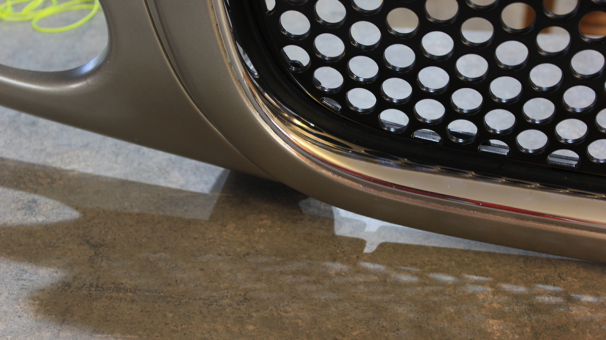

back to sanding again
2 coats of black sandable primer (sorry, no pics, was getting dark)
4 coats of WA38 Pewter Metallic
Plenty coats of clear!
i love spraying, but removing the tape is best part
there's the chrome lip edge i was talking about
mounted
ahhhh, much better!

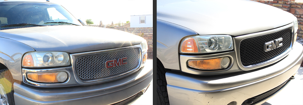

before / after

Nice work on the chrome grille color match! It looks sick! I wanna do it to match my silver birch paint, but I know it's a pretty involved and time consuming process. Plus it takes painting skills I just don't have. Lol. So for now I'm stuck with chrome. Anyways looks good man! The nbs Denali is my favorite body style. Clean lines. Yours looks super clean for 195k! I'm subbed for the progress on your truck!
