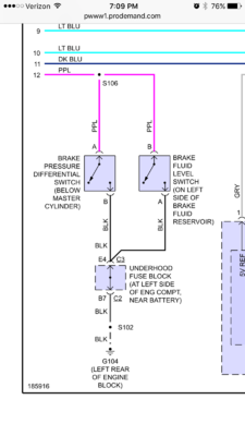

Before you do this, there is something else you need to do. Check you brake pressure differential switch and also make sure both the fluid level and pressure switch have a good ground.
To reverify, it is ONLY your RED brake light that is illuminated correct? No abs light?
