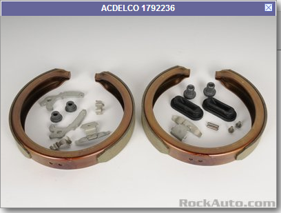

I recently replaced the rear brake heat shield, parking brake cables, and parking brake hardware on my 2004 Yukon SLT 4 WD. While replacing the cable I noticed that the passenger side parking brake cable was missing the parking brake lever. I'm looking for a replacement lever but I cannot find the part or part number. I could you use some help, please.

Looks like it might be a junk yard part. Not seeing them online. Maybe someone here on TYF has one they could send you.

I think they are shown in the RockAuto ACDelco kit (inside the shoe on the left) but I don't see them as available separately.
