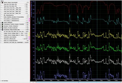

I, as well, have been dealing with codes similar to yours, P0121 (throttle circuit performance, P0171 (Lean bank 1) and P0174 (lean bank 2). I believe I have mine fixed for now by cleaning the MAF. However with the codes and description you give, I would suspect the throttle body too as you mentioned. If you have a way of logging OBDII parameters off the link, parameters I'd start looking at would include commanded throttle, pedal position and relative or absolute throttle position. I would expect them to follow each other. If you are unable to get the info off OBDII, throwing parts at it may be your only option besides taking it to a shop. I think I would definitely start with replaceing throttle body assembly. I've attached a plot of a few parameters from my 07' Yukon XL Denali from this morning's drive into work. The spots where the pedal position is flat yet the throttle is still being being moved around is either where the cruise is on or the vehicle is decelerating. Since you say you can feel it vibrating, I am guessing something isn't quite right with it.
