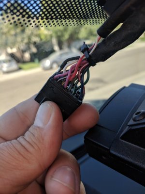

usually everyone taps into the mirror harness, colors for your year may vary but on the nnbs power is the pink wire more towards the middle of the harness and then ground is a black wire int he upper right hand corner, I would recommend using a blend mount so there is nothing in the way of your sensors
