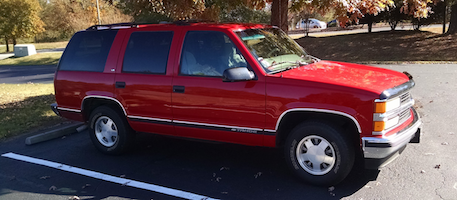

RED TAHOE LS
Jan 2, 2017
774
410
Rossville, Georgia USA
original suspension 226k.
