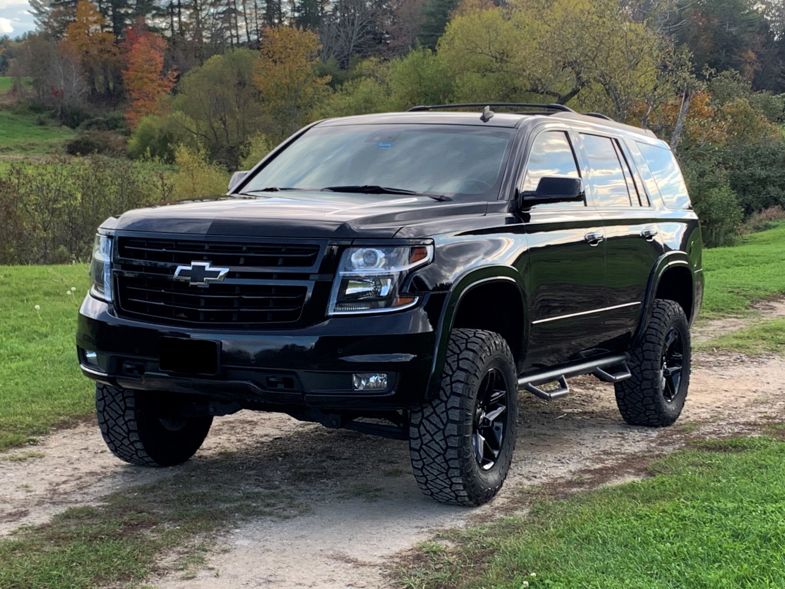

My gloss black vinyl wrap has held up well for several years and 1,000s of miles...
You can certainly find a shop or go at it yourself - all depends on your budget and personal preferences. I have done a little of both.

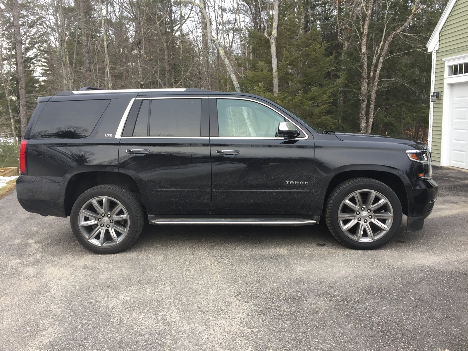

2015 TAHOE LTZ, first day at home after purchase - my canvas to work with, so to speak:

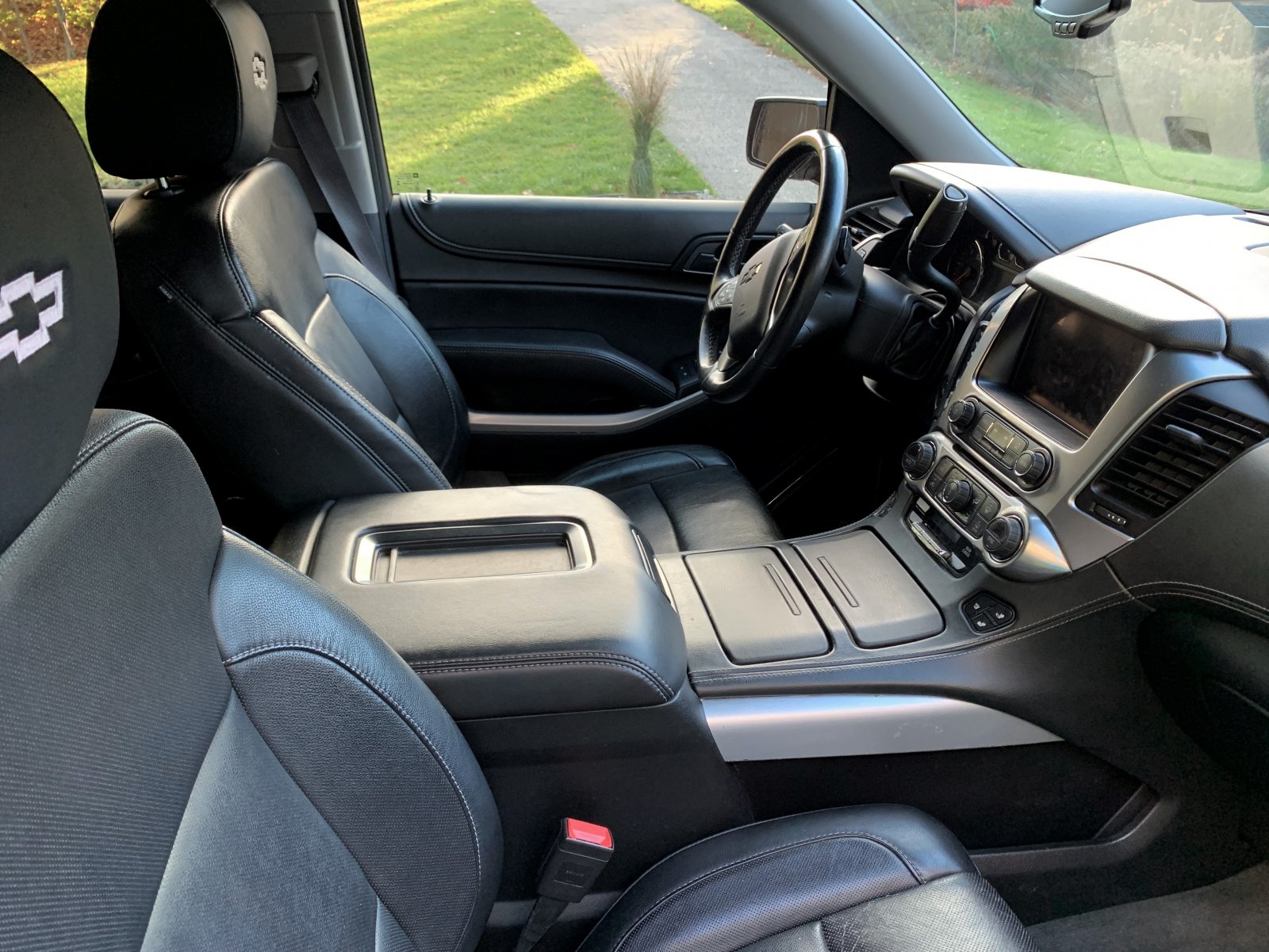

Interior Faux Wood Trim delete - Metallic Silver vinyl wrap (DIY install) with
Interior Chrome Trim delete - matte black vinyl wrap (DIY install) with
Steering Wheel Emblem - matte black vinyl wrap (DIY install)

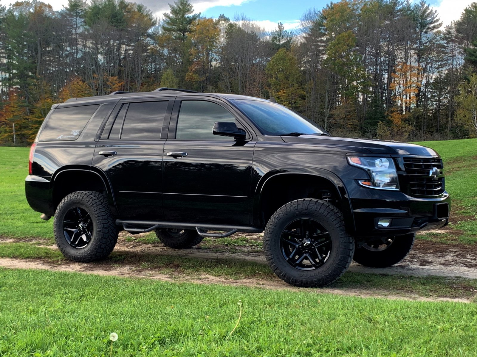

Exterior chrome trim delete; includes windows, pillars, rear tailgate and other chrome pieces - gloss black vinyl wrap (wrap shop install) with
Roof rails - matte black vinyl wrap (wrap shop install & DIY install) with
Rear Tailgate emblem - black PlastiDip (8x coats, DIY install)
InkedBBFCFM - BDS Lift - FRONT LEFT SIDE VIEW Flat Rugged 1a - 10.2021 - Copy3_LI.jpg
Side View Mirrors - new OE covers, painted Chevy black to match (dealer body shop install)
Front Grill - new OE front grille RST trim, black (dealer body shop install)
Front Grill Emblem - new OE black emblem (DIY install)
Fender Flares - new OE trim flares (pained black to match by paint shop / DIY install)
InkedBBFCFM - BDS Lift - FRONT RIGHT SIDE VIEW Flat Rugged 1b - Copy2 - 10.2021_LI.jpg
Front Bumper - z71 trim front bumper has chrome lower valence and does NOT have the chrome fog bezels (dealer body shop install)
z71 Lower Valence - PlastiDip (8x coats) and then added a clear protective vinyl wrap; similar to a hood or headlight protective wrap. (DIY install)
License plate holders - NEW Black holders, front and back. New screws, painted black (DIY install)

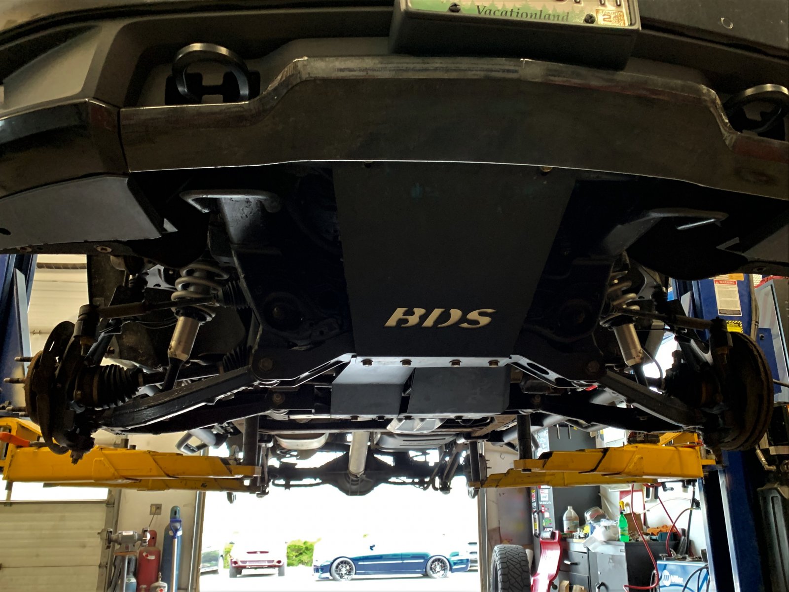

If I had more confidence, or a much larger budget, doing a custom interior vinyl wrap could be really great. Personalized and different. My metallic silver vinyl wrap install on the interior to delete the faux wood has brightened things up just enough and is enjoyable for me. I basically have gone for a black and silver theme throughout, mainly based off my Fox 2.0 front coil overs. The silver springs are very visible and noticeable. My interior was already partly silver so I just took it a step further and brought it all together. My custom Chevy logo headrests only set me back about $50 total and add a real nice touch and again, a hint of the silver.
