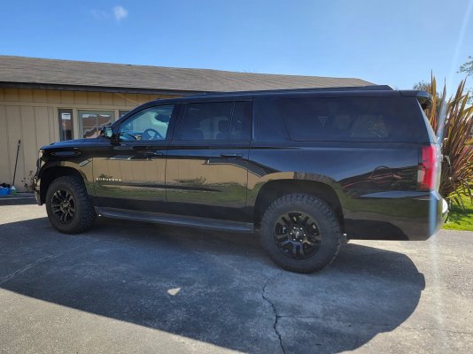

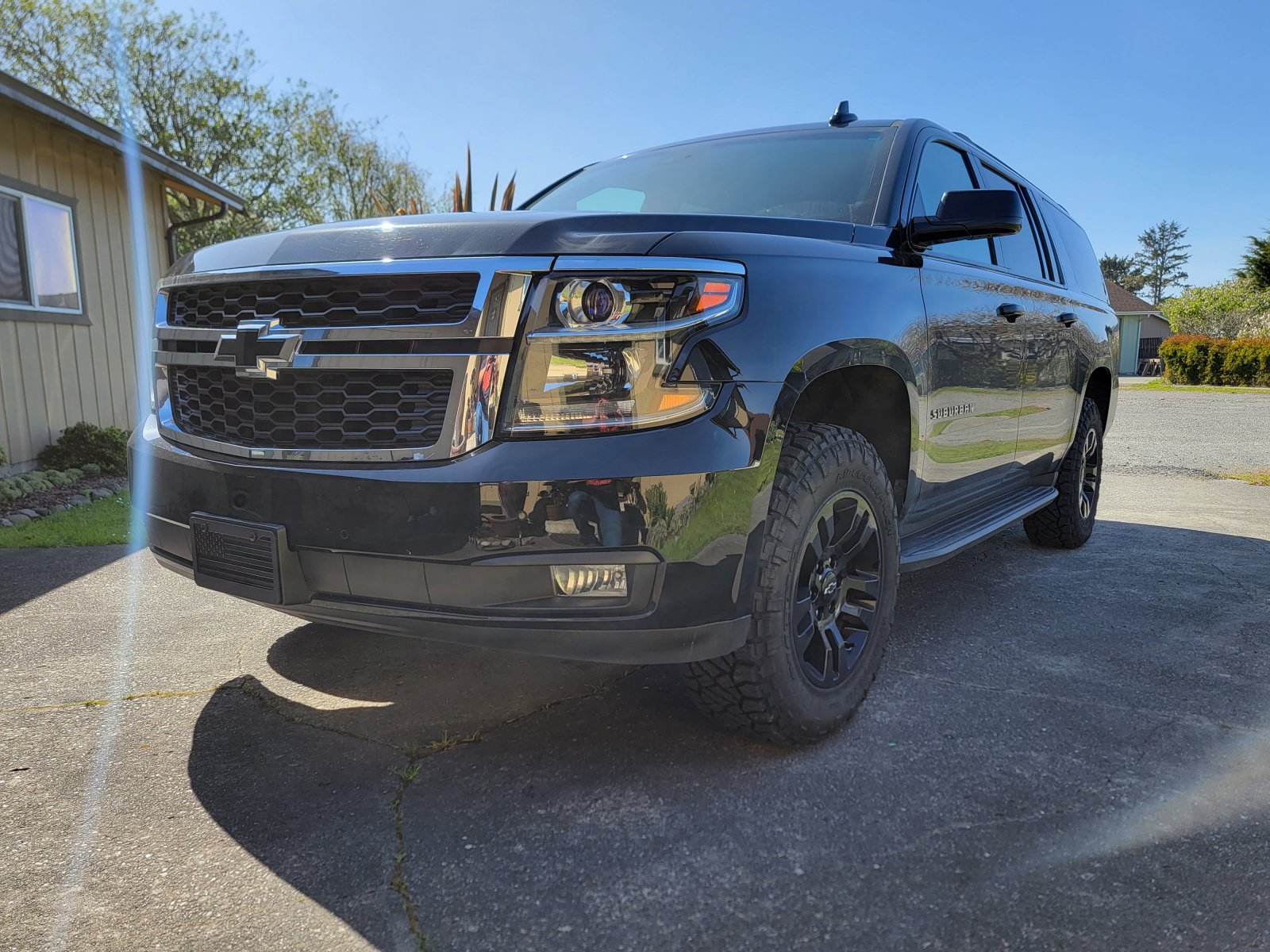

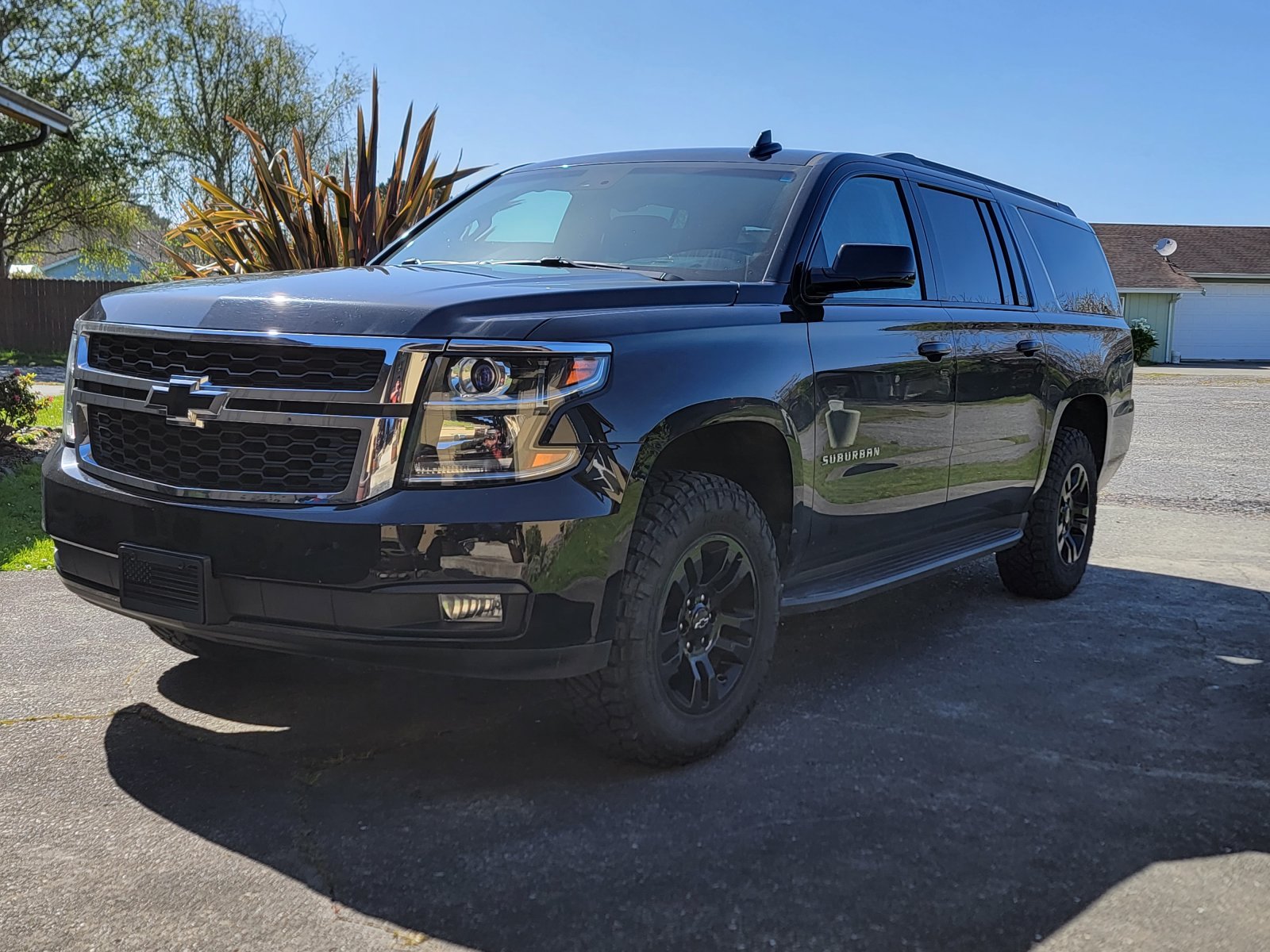

Ok, couldn't help myself. Took a few on the non sunny side. Can't tell how filthy it really is lol. I also trimmed the lower plastic valance right at the bottom of the belly line. Leaving 2.5 inches of material. Little more than the ppv ones, but way less than stock. That alone netted me 4.5 inches more of ground clearance for parking, now it's more with the tires and level. Not sure why these pics didn't come out right on the post but they look better if you click on the thumbnails and view them that way.

Got a measurement on a different flat surface. I think it was my driveway causing it. Both front sides were 37 & 1/8" exactly. Rears were 38 & 1/2" and 38 & 1/4", so very close. The original front measurement was 35 & 3/4". I just thought it was odd that I had one corner so far off before. Could have done the full kit with the upper spacers but this looks great to me, and I didn't want to deal with the ball joint issue, or having to use a wheel spacer because I went too high with the stock wheel. Definitely happy with it!
