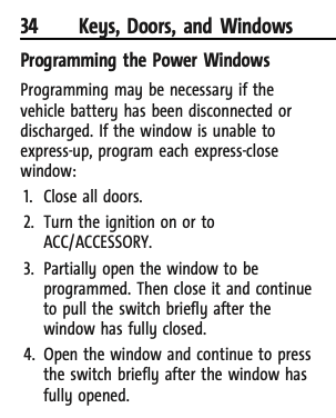

Probably a sign of low battery. That is the auto up/down feature calibration after battery is disconnected, from the owner's manual.
