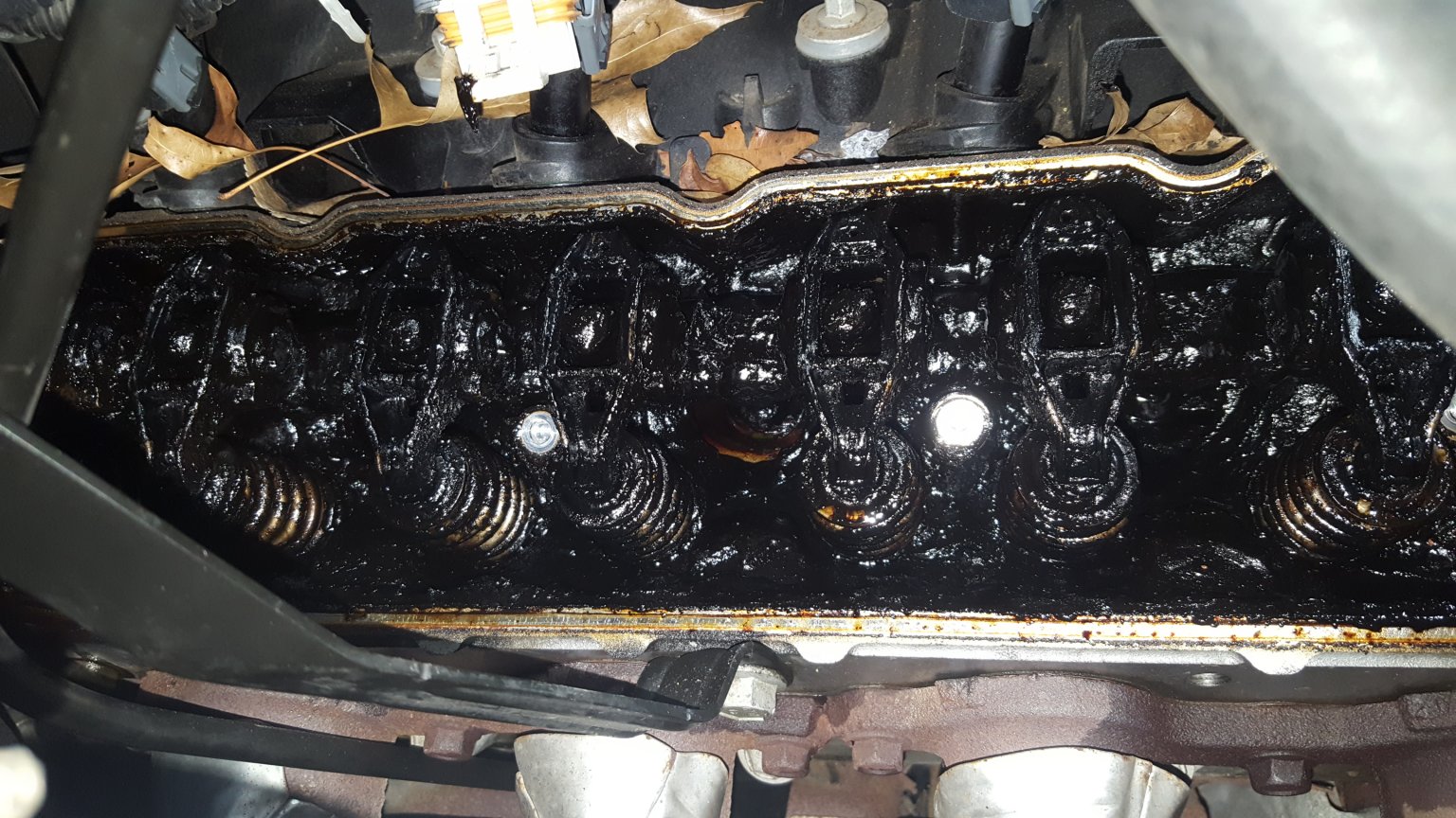

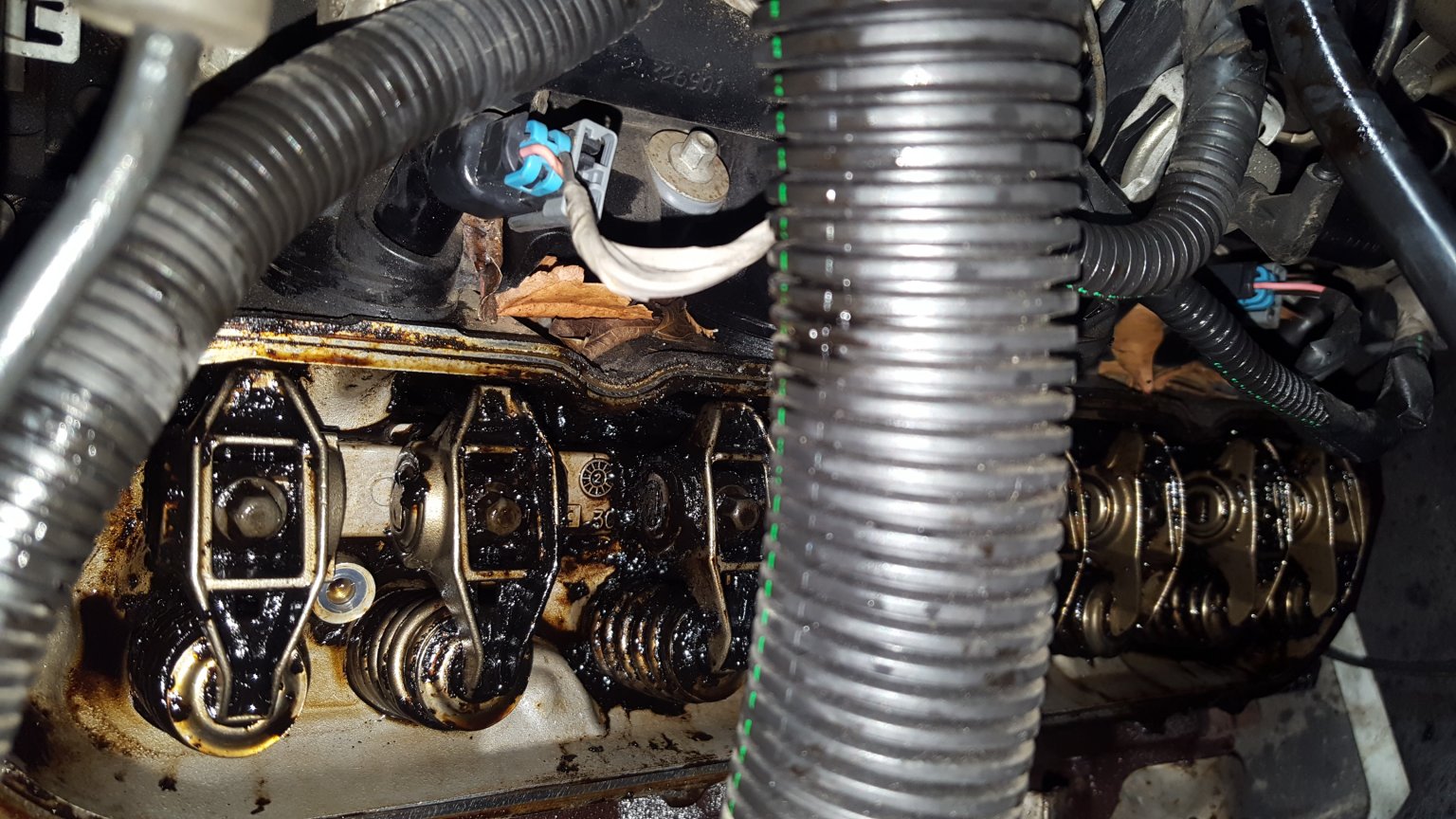

I'm not doing anything yet. just looking at my options. 2200 is worst case if the bastard just absolutely has to come out. I don't want to spend money that I don't have to.

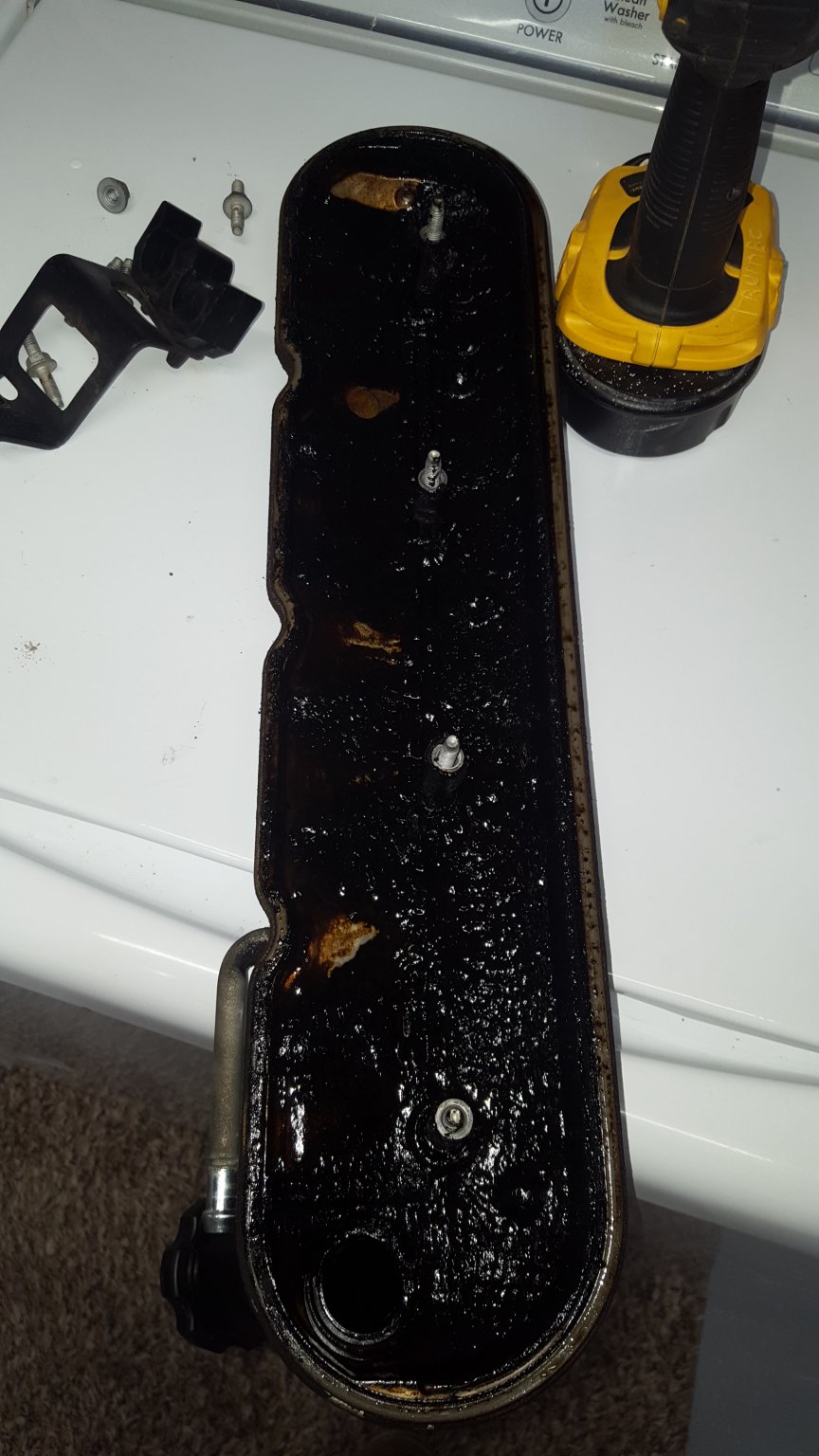

first step is pulling the pan, and cleaning the timing chain area, and the heads. then diesel wash everything so it dissolves and drips out the bottom.
then bolt everything back up and do some sort of a high detergent flush. I haven't got that far yet to think about what to use.
hopefully this all does the trick, i install the knock sensors and harness. and I drive happily for many miles
also today I found 2 broken exhaust manifold studs, one on each side at the back of the motor.

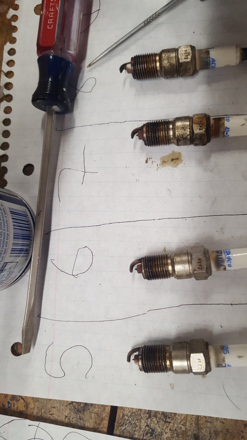

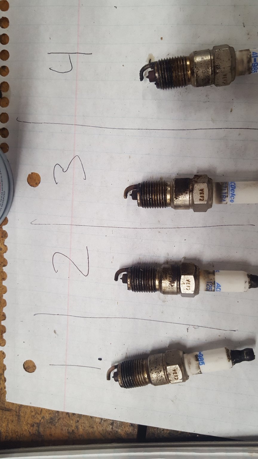

kinda hard to see, pretty sure OG plugs. pretty crusty, #7 has a crack.

Heads are a dime a dozen and replacing them isn't difficult at all if you already have the valve covers and intake manifold off (Gotta love that dry intake design!). The rear exhaust manifold bolts breaking is another common issue- so common that there are bolt-on clamps to fix it as an alternative to trying to drill out the broken bolts. But, if you swap the heads, your fix will be even easier.
I'd be shocked if the dealership does anything about this. I'm sure it was sold "AS-IS" and they'll stand by this. But, if anything was clearly intentionally misrepresented, use social media to put the ******* on blast.

To be honest I would fill the engine with diesel. Will it through the oil fill to the top. Let it set overnight drain it through the oil pan and do it all one more time. After the second time fill with fresh oil and filter run for 10 minutes change oil repeat until oil is clean. I know you said you didn't want to clean it but that's what I would do

I've never heard of this method. If it's effective enough, it would surely be an easier way than disassembling the motor. But, it still falls in the category of "whaddaya have to lose?"

Just keep in mind you will have flammable vapor in the crankcase after you drain it. Another tip is to stick a air chuck in the drain plug with the oil cap off. This should push the flammable vapor out the oil fill cap.

Like kerosene back in the day....after diesel or kero, change oil/filter a few x and then do 1 or 2 oil changes with tranny fluid and filter. Again
