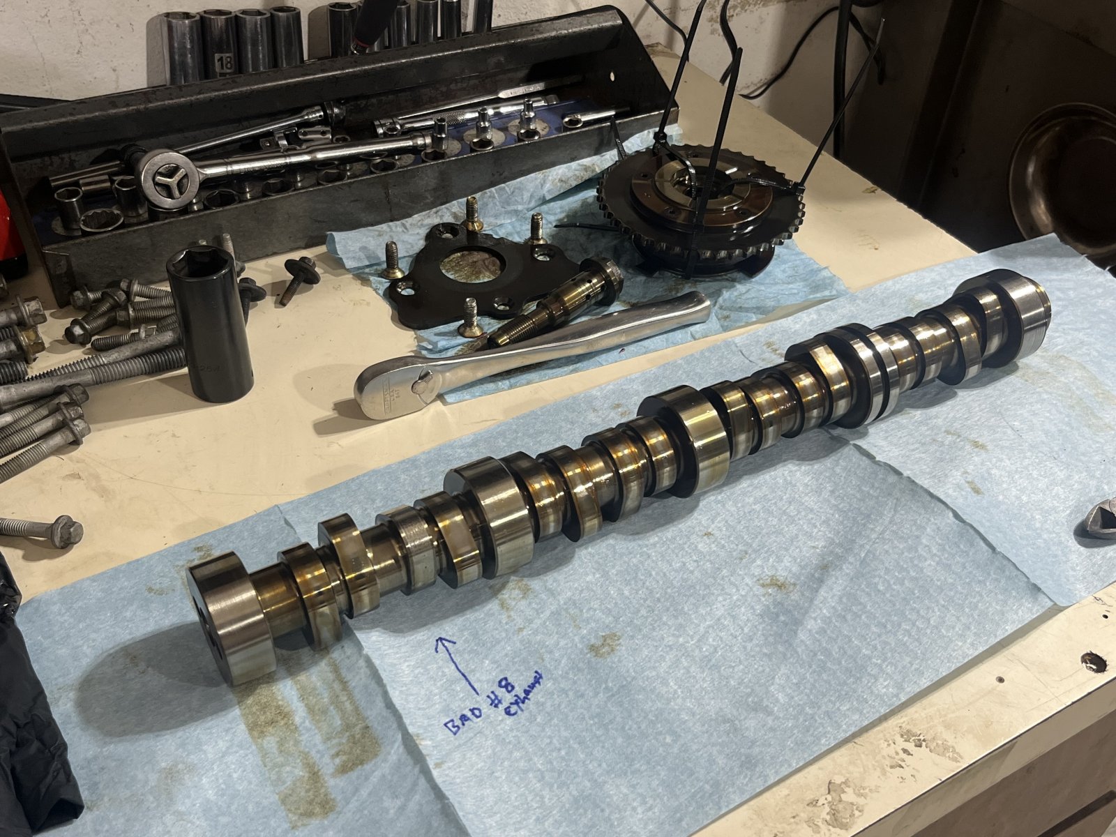

Stole this thing with a cylinder 8 misfire. Swapped out the cam and lifters with a regular 5.3 cam and a set of LS7 lifters. Followed up with a AFM delete from LT1swap.com for $50!
It’s running like a top! Plenty of power and just pulled 20mpg on a Fort Lauderdale trip.
