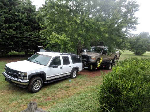

We took it to Tn to get a Yukon to bring back to flip, and this is how the trip ended.
It started knocking, and I thought was a cracked flexplate, with a bad back I wasn't working on it in TN, so I sold the Yukon, bought the F250 (which will be fore sale shortly if you are interested), and towed it home, and took it to the shop. When they drained the oil the #4 rod bearing poured out. That is the second engine that truck has had in a year, I am done with it.

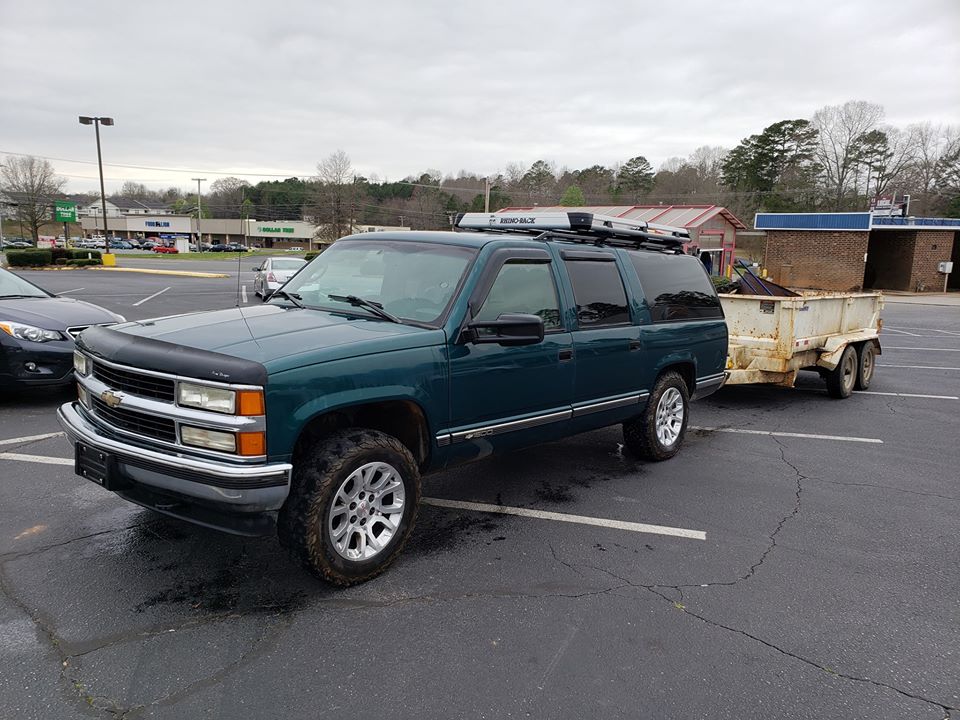

So I found a new truck, a 95 K1500 Suburban nicknamed #7 (think Grizzly Adams). And I am making it into a work truck. Follow along. It might be good for a laugh.
Here it is the day I bought it.
Ain't those grandpa steps sexy.

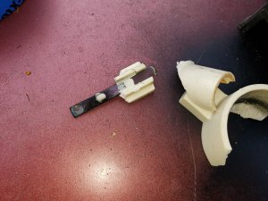

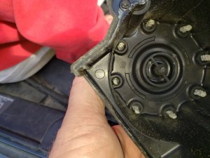

This morning, Heath and I went to the scrap yard. On the way back the dash nearly fell out of #7. These GMT400 trucks had a major flaw in the dash design. There are two 10mm bolts that hold the bottom of the dash up. And there are three small screws that hold the top. The three small screws go into steel, the dash is plastic, the mounts break, especially if you do much driving on rough roads ( or non existent roads).
You can buy premade clips to repair it, but I am cheap.
I dug through the metal pile and found a piece of aluminum. Marked it
I put it in the redneck bandsaw, and used the worlds dullest hacksaw blade.
Then I changed my orientation.
A pass through the redneck Bridgeport.
My super high tech angle finder.
Then a run through the redneck metal break.
Finally a few of these odd sized washers for the two mounts that were completely broken off.
And finally the clips installed.
It wasn't bad except for the bad sawblade. Total time invested one cigar.

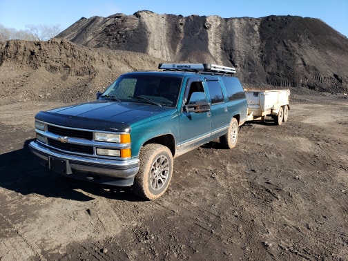

Paused for a glamor shot in front of Mt. Asphalt.
And brought home 10,000 pounds of old roads.
