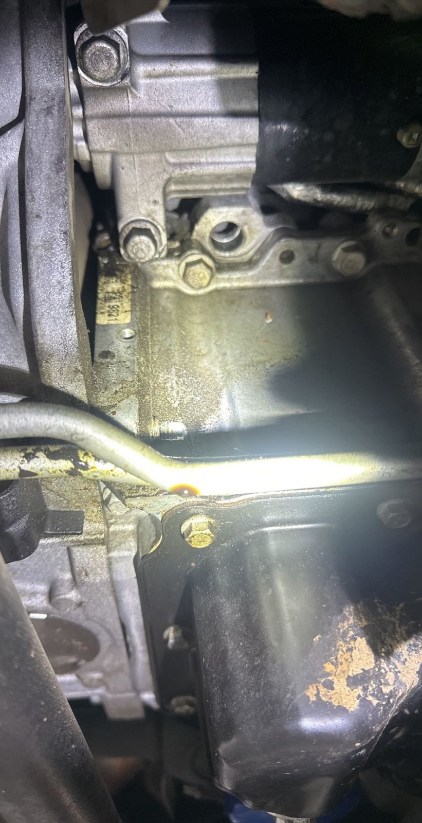

Has anyone replaced their oil pan gasket? Dealership said mine was leaking and with a quote of $1,400 to replace it thats not covered by my warranty I'll be looking at doing it myself. There must be some long labor hours involved to get a quote that high haha Its the 6.2 4x4 if theres differences.

just had mine done (under a 3rd party) warranty I guess there is a upper & lower pan, both of mine were leaking
it was indeed pricey. oil pan, water pump, oil cooler lines and pinion seal they hit the warranty for $3k
on the 4X4 the front diff has to be lowered at least part way to get the pan out, probably the reason for high labor
I have not done one myself in a long time, but you want to do it right otherwise it will leak again, bolts have to be tightened to torq spec in a pattern
and usually the front needs silicone, alignment has to be just right

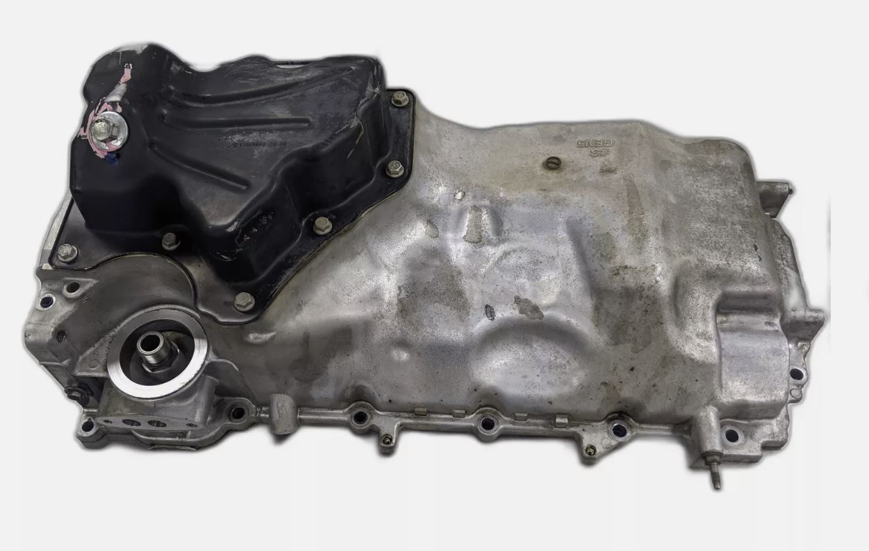

Stamped steel oil pan huh? Thought that was a thing of the past on these rigs.

Just did that on my 15 while getting to the oil pump solenoid. But yes, it is labor intensive, to a point. Could easily just be a weekend job if your mechanically inclined. Drop the front differential and you'll gain access to everything from the bottom side Gaskets are cheap, but the labor and time is expensive
