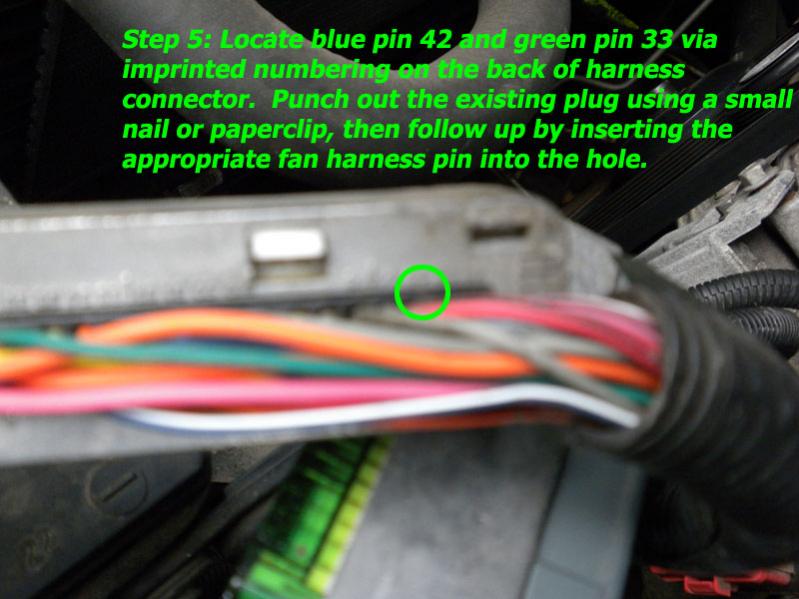

How difficult will this step be to perform, and where can I get the pins to put on my wires
PIN 33 for yours will need to T-tap to the A/C compressor wire in the loom next to the red junction box. You don't need to purchase any PINs, you are already good to go with what you have.

Thanks, I'm sure I'm probably making this harder than it is. I get a little paranoid, Last time I tried to knock a pin out of my AVICF700BT it wasn't to succsesful and I had to get another harness, I'll just have to be more careful
