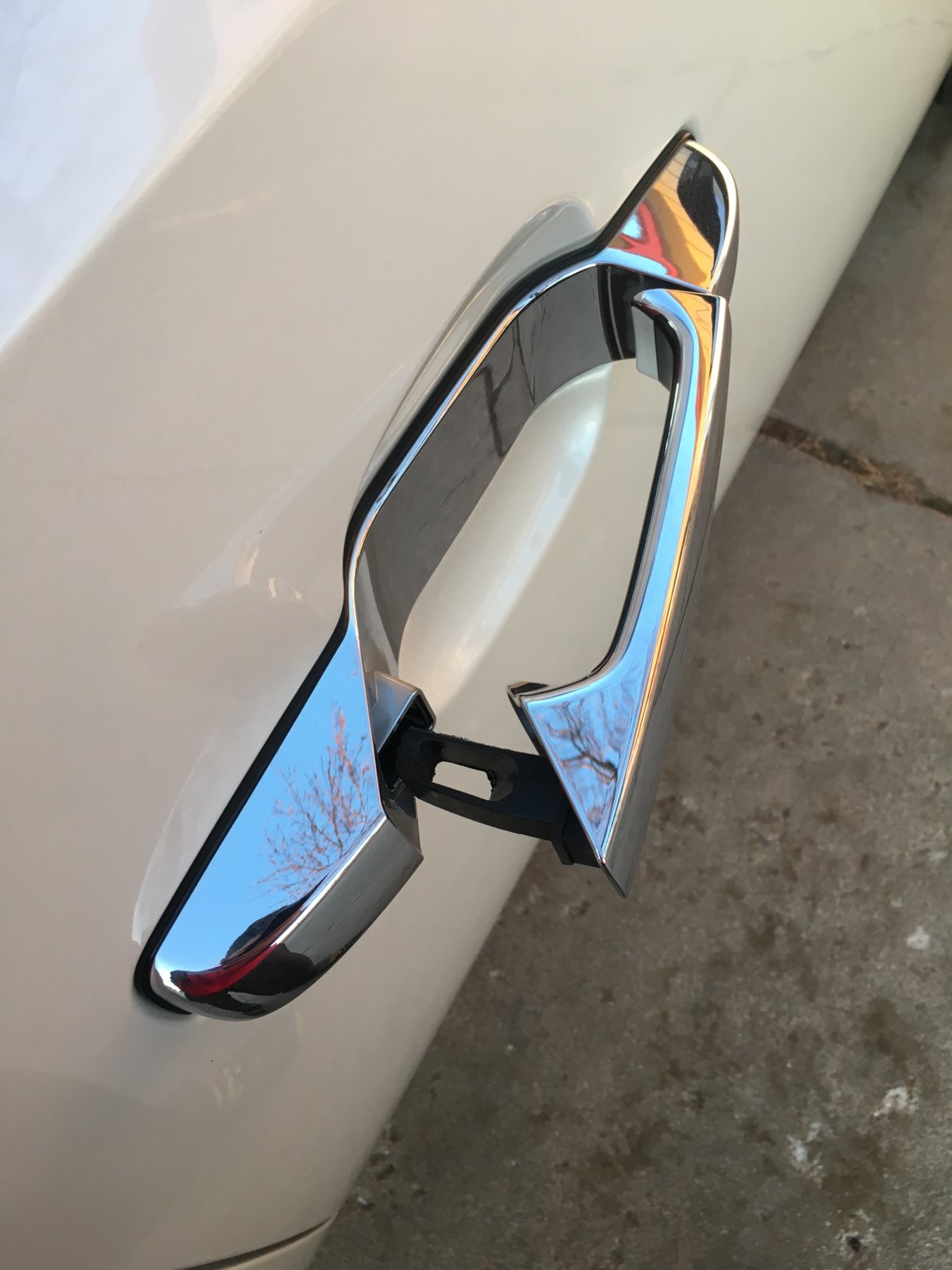

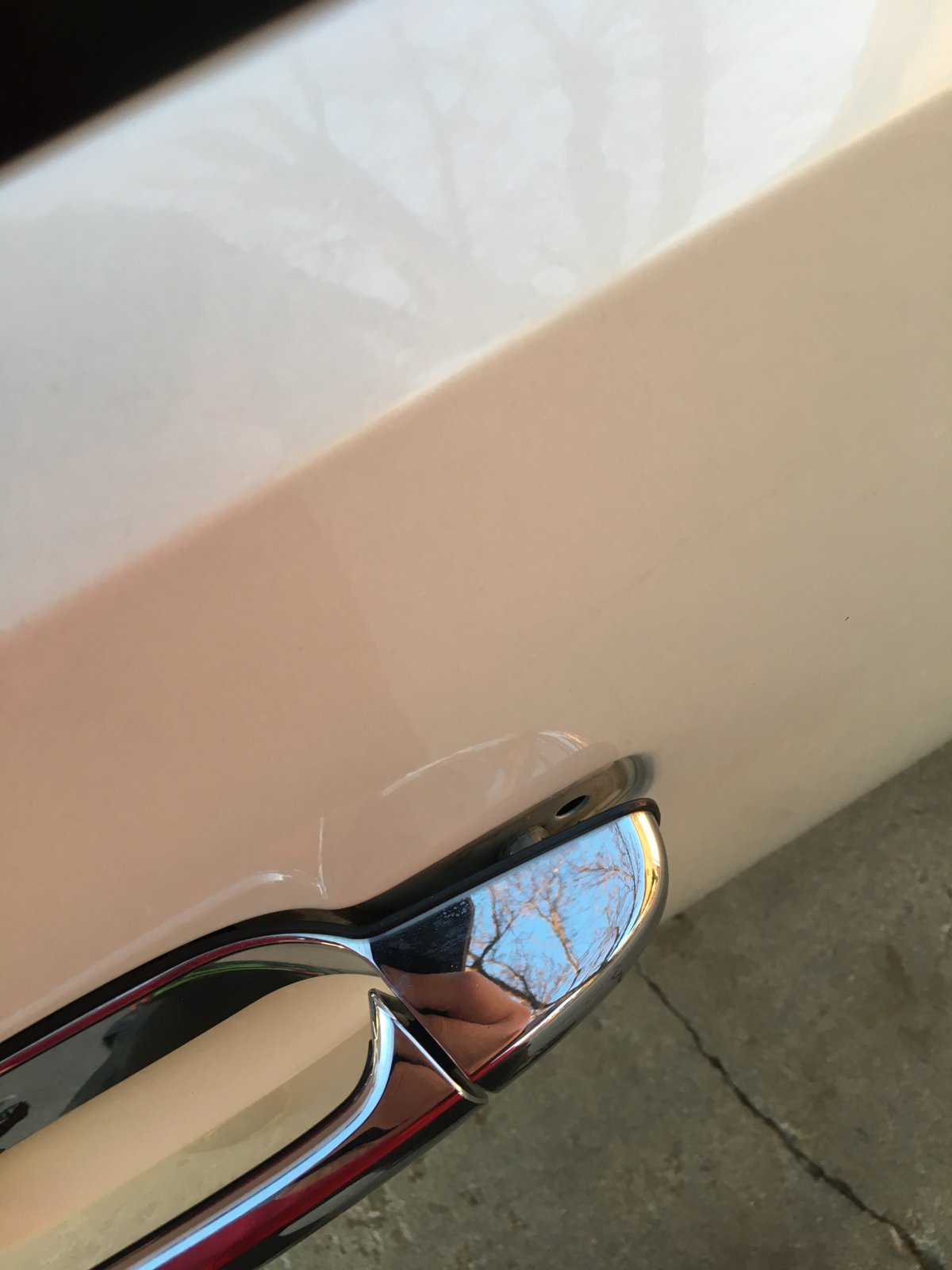

Well shit
Pass front door handle (not usable)
Pass rear door (still opens door)

Had that happen on the Yukon... sucked. And I had to use that door asap so I had to pay big money from the dealer

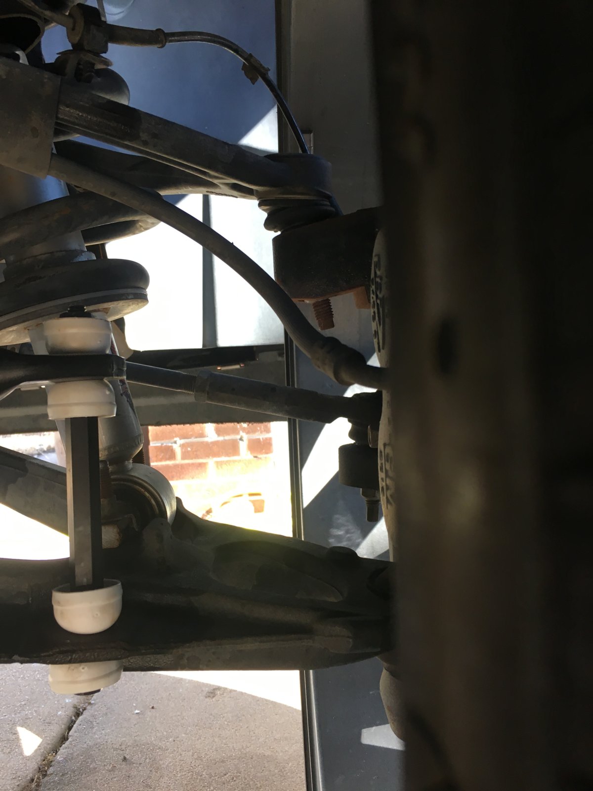

Nothing major just replaced my sway bar links with some Moog ones. Trying to chase down a squeak. Thought these might be the issue but they weren’t. Still needed replaced

Same brand and style I have on the front of my Tahoe cause the Belltechs are junk. Check the sway bar bushings for the squeak. I had a squeak when I first lowered my Tahoe and then went with some greaseable Energy Suspension bushings and the squeak went away.

I threw some wd40 on them to see if it would go away but after bouncing the truck a couple times it came back. May still change those out tho

Done tried the WD-40 trick and it does not work. You have to change them out to the greaseable kind.
